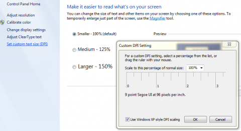

Re: Laptop screen adjustments
Attached are screenshots from my computer with regards to display settings.
Thanks Dennis.
Those are the settings that I'm using .

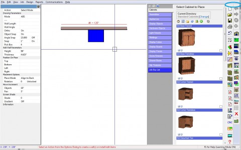

You can drag the toolbars at the top and attach them to the side of the window by using the dotting line at the beginning of the toolbar.
Rick Deskins
Good stuff !!
That really looks good !
I will be definitely trying it out.
Thanks for the solution , Rick.
