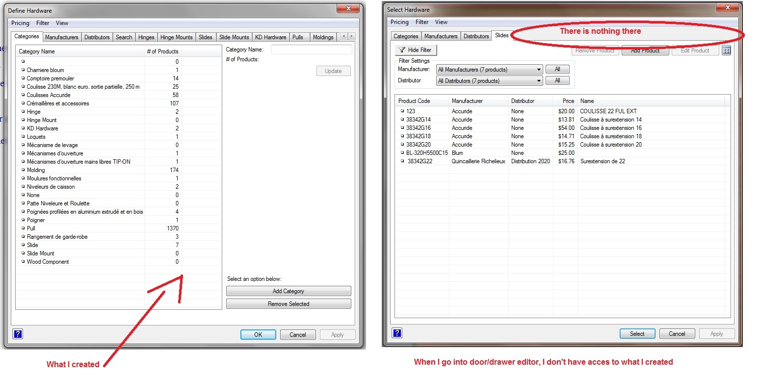

Hi,
I have a question. I created many hardware, i added new categorie and a lot of thing, i use it to make quote. I would like to transfer this to an other computer. So i click on princing, than export, i selected to expert everything. I toke the excel file that was created, i transfered it to the other computer. I opened eCabinet, i went into define hardware, i cliked on pricing, i clicked on import, select my file. Than it says i need to click on ok or apply. So i click on ok, the window closed, i click on apply, but nothing happend... I am not able to transfer all the hardware i created. Does some one knows how to do it?
Thank you!

I have an other question regarding this. I have created a lot a slide in a new categorie. When I go into the door / drawer editor nothing appear. The only place I get add an hardware is in the main view in the right panel window, cabinet buy list. Is there any possibility to have acces to it in the door / drawer editor?
Thank you!

With regards to your drawer slides. There is a category for slides, so that is where you would need to place them. As you've found, if you put them in a category of your choosing, then you have to add those manually. If you add them to the Slide category, then the software automatically adds them to the buy list in the required quantities. So in this case, whenever possibly, use the categories that are available.
Dennis

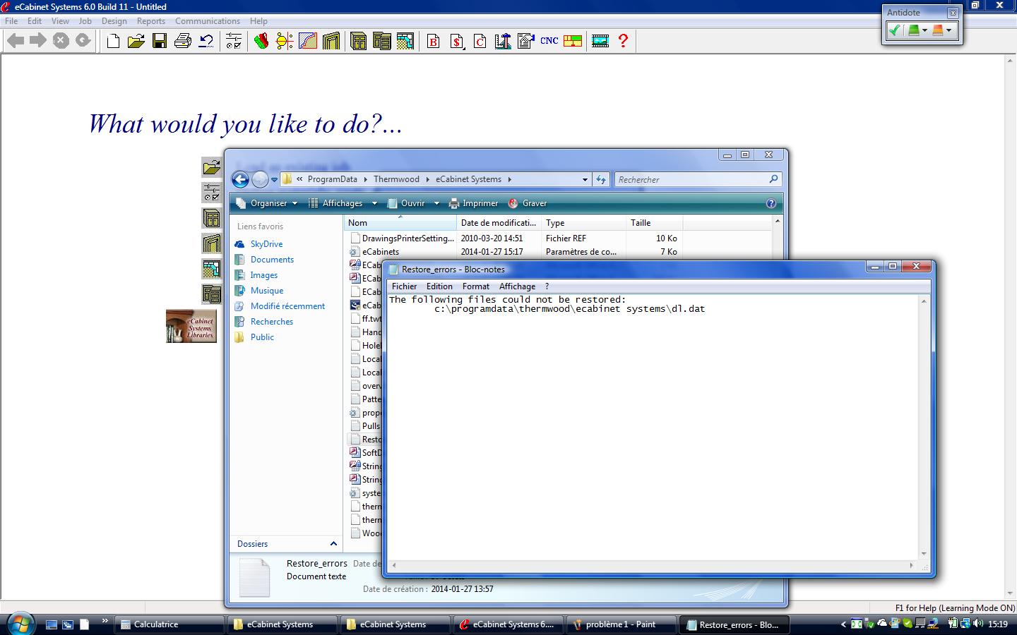

I tried the backup thing but when I transferred it to the other computer I get this: see picture attached. I try many time but always get the same thing. Does someone know how to solve this problem?
Thank you!
