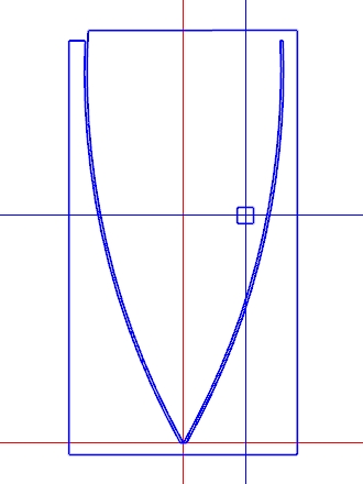

Can you post any specs. On the unit i.e.. Angles and dimensions etc.
A drawing would be great.

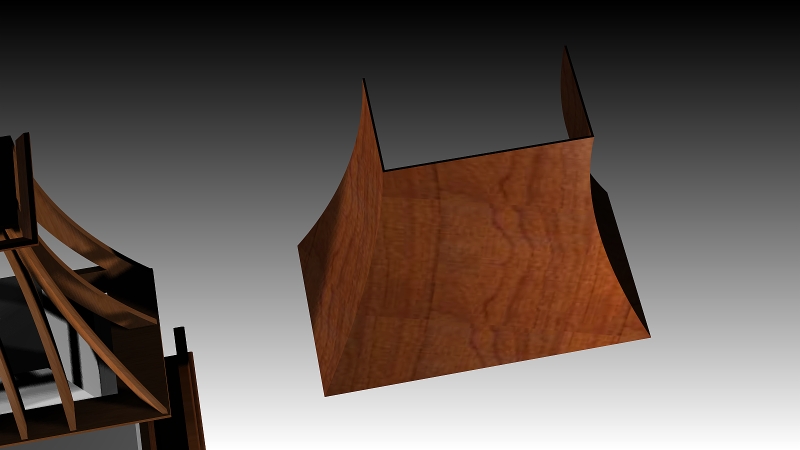

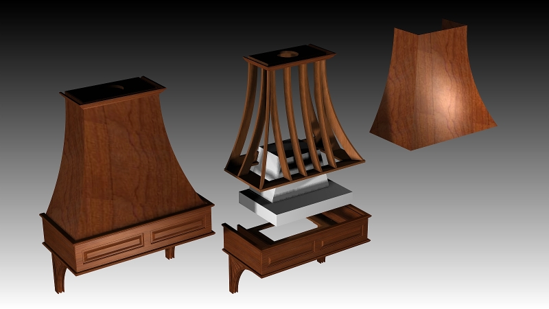

Re: Display cubes and part editor
Chris,
Here is a look at the tool I used to cut the skin for the heed below. It cuts both sides to leave a 1/4" skin.
