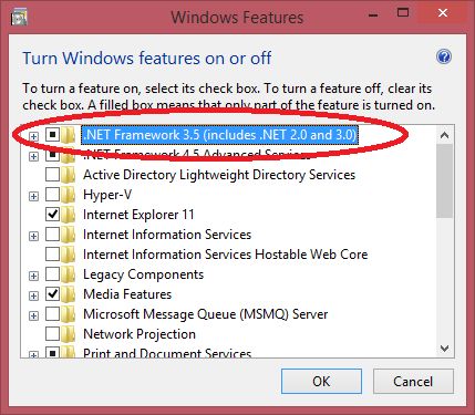

I will assume that the new PC has Windows 8 or 8.1. If so, try doing the following:
> Go to Control Panel, Programs and Features, then select Turn Windows features on or off.
> Now, in the Windows Features dialog, Check on the .NET Framework 3.5 (includes .NET 2.0 and 3.0) option (see attached picture), then select OK. Download the required files and let it install.
> Re-run the eCabinet Systems install and choose the Repair option.
> Launch eCabinet Systems and see if the issue is resolved.

Thanks for the fast response, Scott. That worked perfectly
Brent
