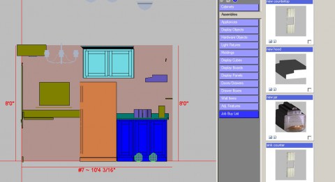

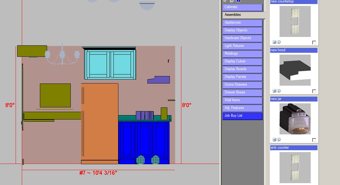

Apparently that wasn't the issue cause I'm still having problems with wall associations not working correctly. This is a shot of 2 jars I created out of display cubes. I hight-lighted them. They have 2 wall associations, #7 & #1. I can move them left or right but can't raise them off the floor. I've done this hundreds of times so I know how to do it, just eCab isn't cooperating.
I am also still losing stuff in render mode. I might get a good render, but if I adjust the lighting and render again, a bunch of stuff is gone. It has to be a software glitch. One minute it works and the next it doesn't. I spent an hour yesterday running a Malware and security sweep for bugs, nothing. No Windows updates running in the background this time

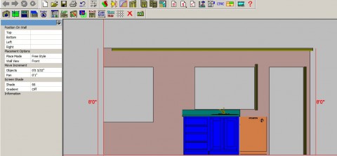

I am such an idiot, I forgot to take the placement mode into free style DUH!!!
