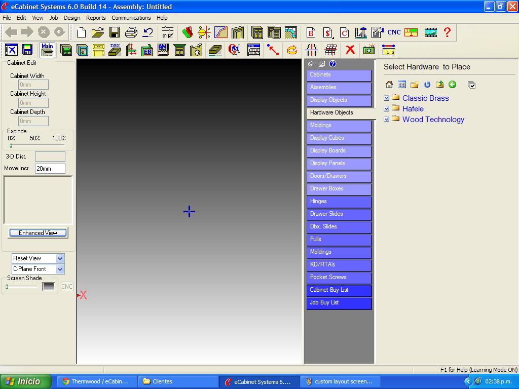

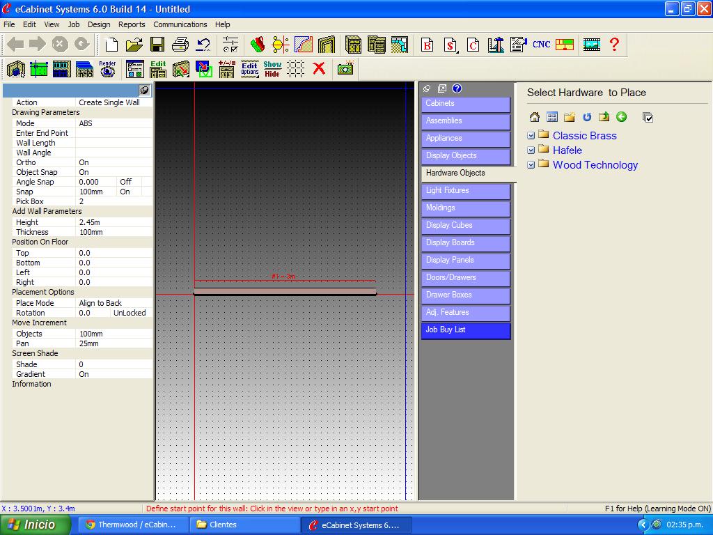

Rick Deskins wrote:under the hardware objects tab in the item window, do you not have a directory for Lazy Susans or Wood Components?
This is what I have (nothing):

Rick Deskins
Posts: 858
Company Name: Thermwood
Re: Lazy Susan does not install
Post by Rick Deskins »
When you are in the hardware objects tab, hit the home button to go back to the root of the hardware objects.
Post by Cesar Font »
Oh my god !
All this time I thought I was at home, it must have been 4 years ago or more that I clicked on the pulls sub-directory and because the program stays where you last left it, after all this time I never thought there was a home to go to !!! :oops:
Thank you for your quick response.
