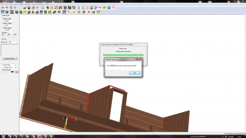

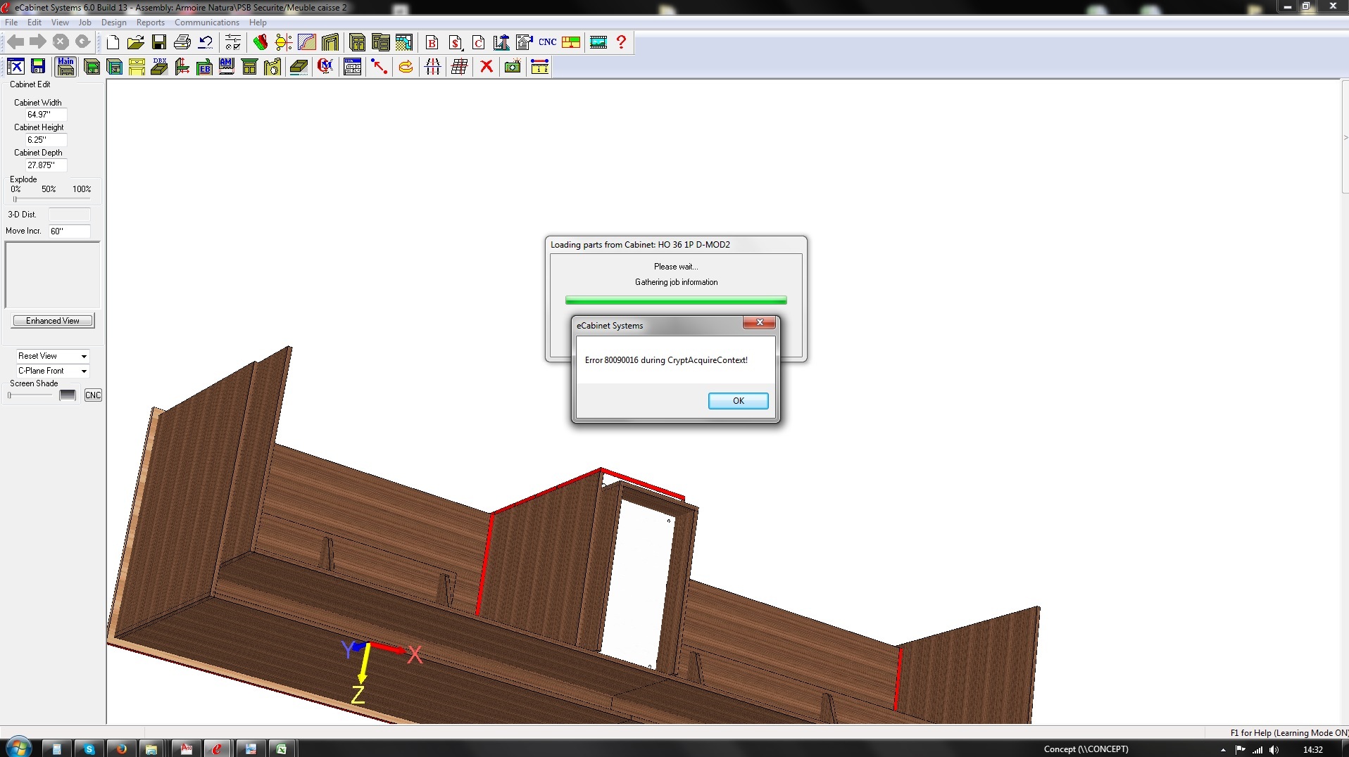

I have a question. I'v been working on this assemblie and I tried to write the CNC file but I always get this error message: Error 80090016 during CryptAcquireContext! I tried from the layout and from the cabinet editor and still have the same error. I didn't try to change the material tichkness. Is it possible to let me know is wrong with my file?

1. Save the file from the link below to the desktop.
2. Open up a command prompt and then type "cd desktop" then enter (do not type the quotes).
3. Next type "thmcrypt.exe" then hit enter. it should tell you 3 files have been copied.
a. If it does not and you are running XP, you will need to go into Windows explorer and delete the following directory, "C:\documents and settings\"user name"\application data\microsoft\crypto\RSA". In Windows 7 the path is"C:\Users\username\AppData\Roaming\Microsoft\Crypto\RSA".
4. Once that directory is deleted you will need to run the thmcrypt.exe file from a dos prompt again.
http://www.thermwood.com/download/temp_ ... mcrypt.exe
