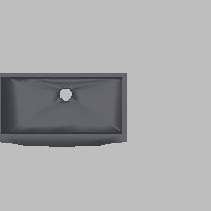

Ive been playing around with stl's a little bit
Not sure if this is workable but see how it goes
kraus 36a.jpg (4.02 KiB) Viewed 12790 times
kraus 36a.hsf
(56.02 KiB) Downloaded 714 times

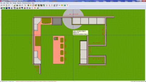

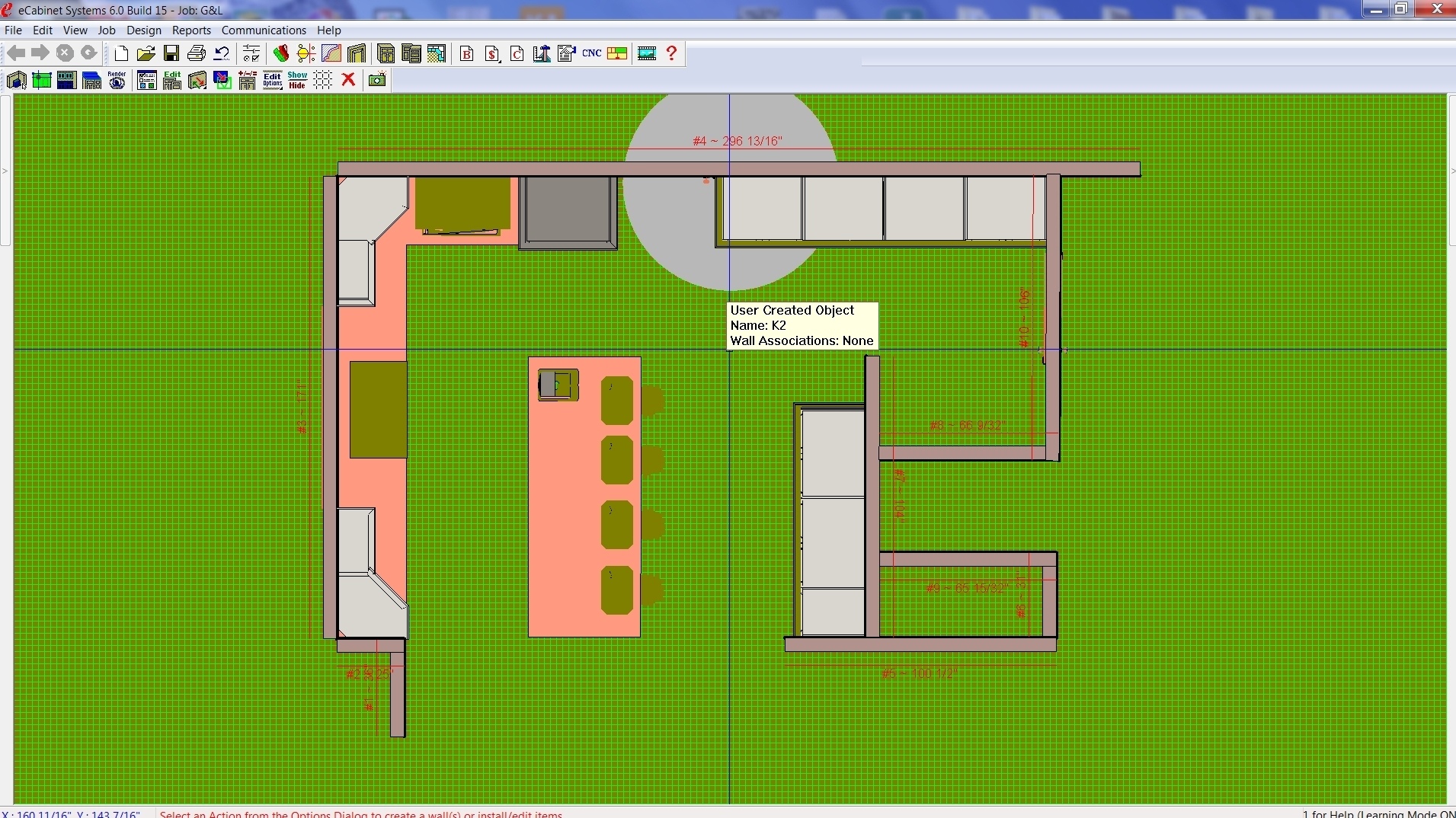

Mark -- there is something wrong with that HSF. It screws up my plan and I have to hit UNDO before my screen goes back to normal have a look at this and the big circle behind the plan--
Re: Apron front single
Hi Wally
I see what you mean.
That round circle is the drain hole :(
The sink was about 19meters wide so the whole kitchen was in the sink.
I took it back into the part editor and have resized the sink so hopefully this one might work.
kraus 36b.hsf
(54.02 KiB) Downloaded 759 times

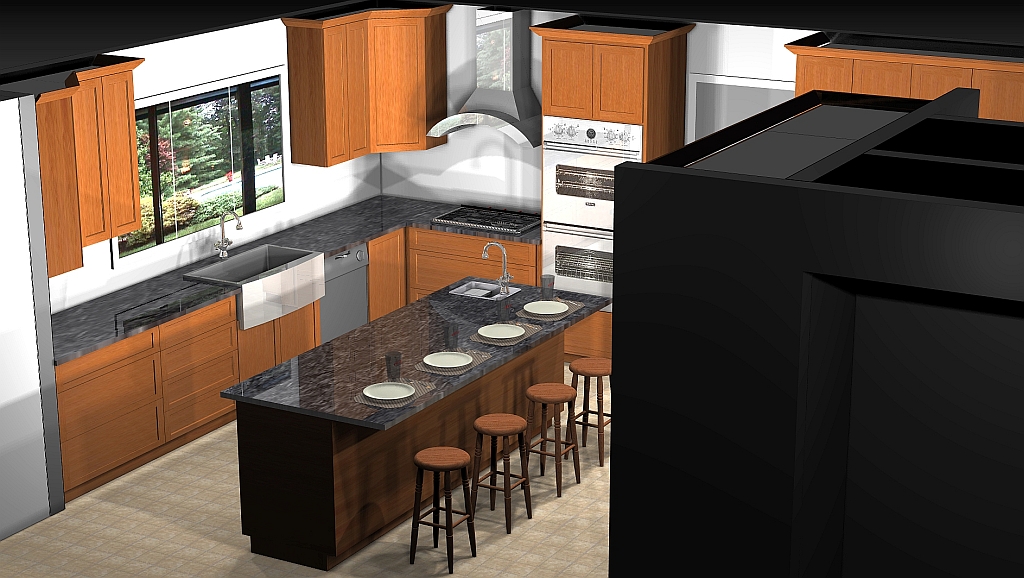

You did GOOD Mark!! LOL. It works well now -- have a look --
Hi Wally
No problem.
That's a nice decent sized kitchen.
You have put a lot of effort into the presentation. It looks great! I hope you get the job. :)
I haven't actually seen stainless sinks like those, perhaps they will be the next big thing.
I thought you might have put the stone over the top of the sink edge.
I suppose they load the gap between the sink and the stone with silicon?
