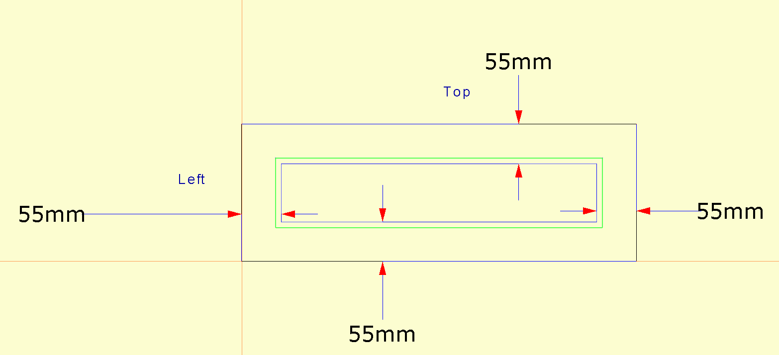

Hi there, i've just recently got the latest build for ecabinets, and now ive noticed that when i do a profile cut (on a door) and go to contraint mangage it, when i get out of the contraint manager after applying the changes and then go back into it, the contraints have disappeared from the profiling and when i go to change the size of the door, because theres no restraints on the profile cut, its all messed up. Help??

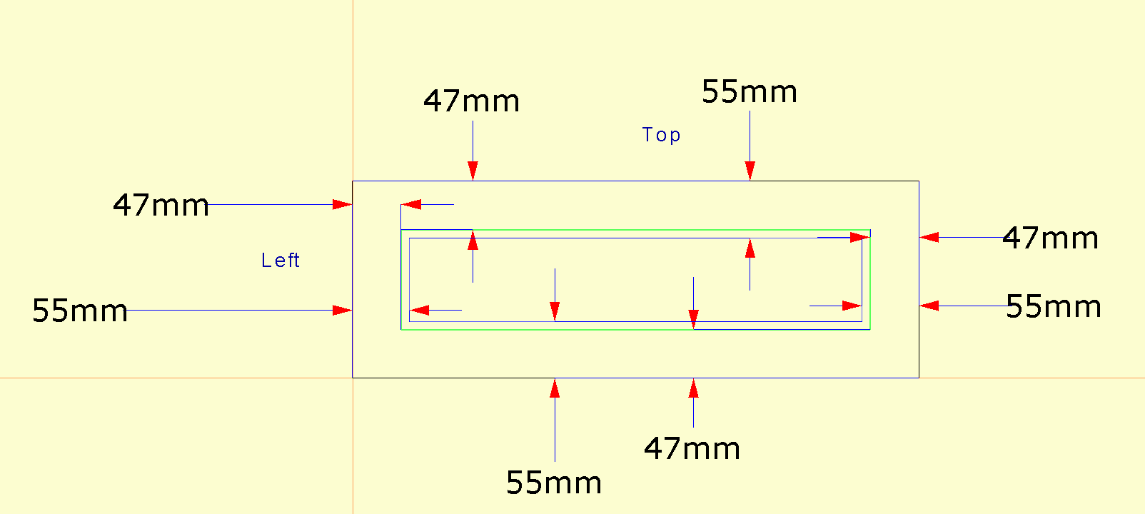

What i want, then exit out and apply changes...
Then after going back into the contraint manager, they have disappeared. Never happened to me before!

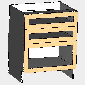

Drawers.hsf
(1.5 MiB) Downloaded 868 times
Hi Scott,
This is just one that's in my library which i have been using for years, havent changed anything to it. Now when i go into contraint manager, then exit out (and hit apply changes (even if i didnt do any)) then i go back into it, the profile constraints are gone :wall:
Shaun

I was able to reproduce your issue and it appears to be afflicting only back side profile cut paths on doors and drawer fronts. I have it listed and we will get it resolved as soon as we can and have it included in the next release. Sorry for this inconvenience.
As you have probably noticed, if you do not take the drawer fronts back to the constraint manager, they will retain their previously set constraints. You can actually go to the CM and work on other parts, but as long as you do not select any of the drawer fronts to display in the view, you will still be ok and it will maintain the prior constraints.
