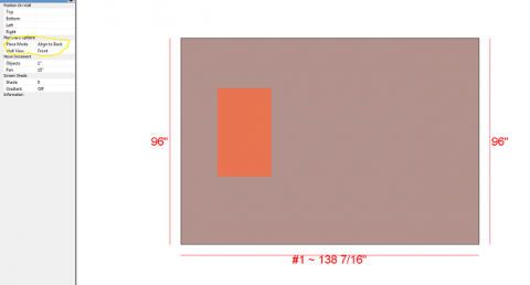

Re: reverse build wall cutouts in elevation view
When placing windows and doors you can reverse the wall by selecting front or back
Hope this helps
thanks Tim,
