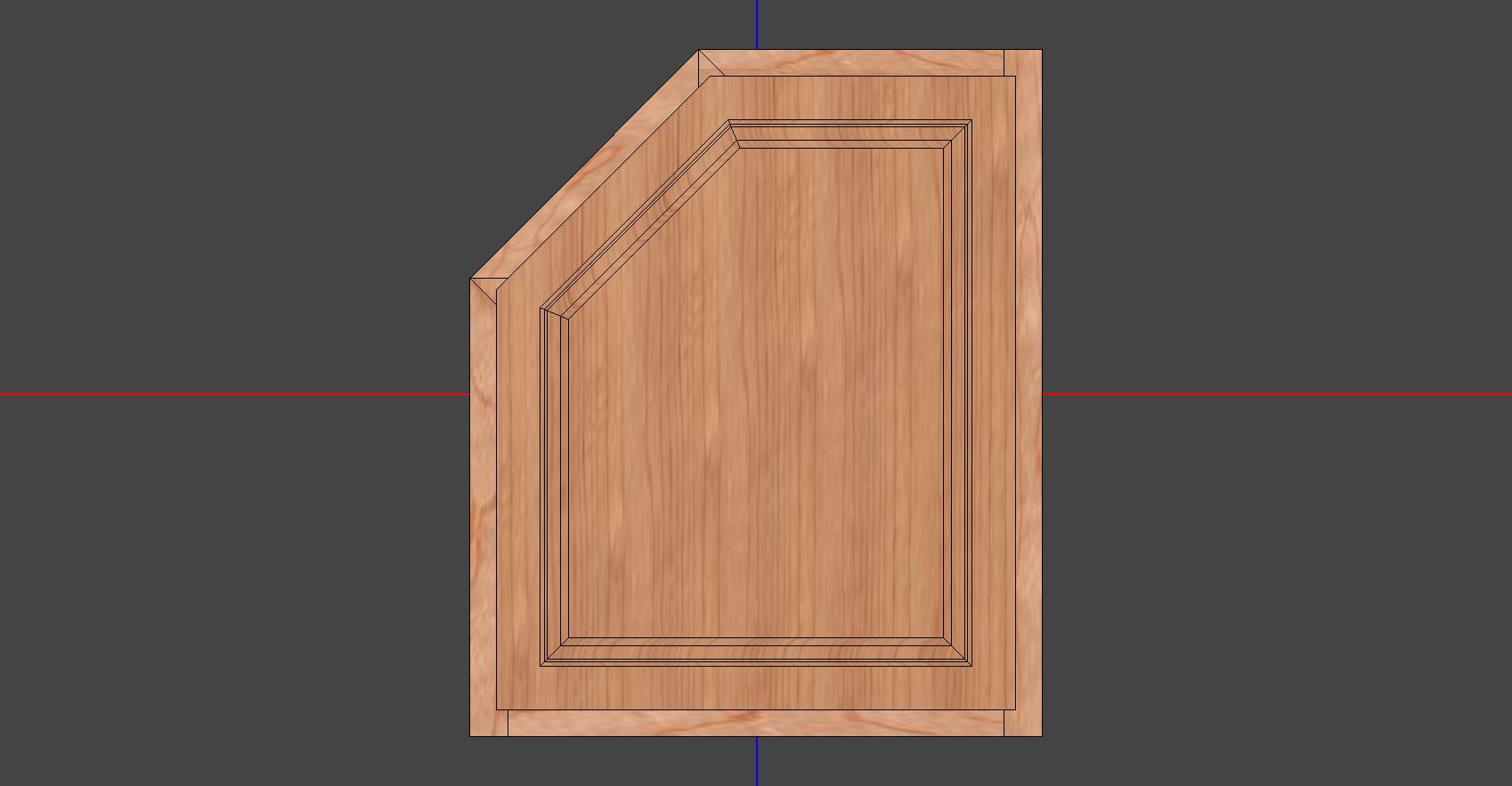

Hi Leo
The only FF part that would have to be placed manually would be the angled piece. In the image below I used a display board but it may be possible to use a stretcher (have not tried that yet). The door is a slab door with the same angle cut on it then I used the MDF_ASYM-6 tool to cut the raised panel.

Leo Graywacz wrote:If I resize the cabinet do I have to remake the door?
If you constrain the geometry for the cut as well as the profile you will not have to redraw the door. You will however have to redraw the display board.
