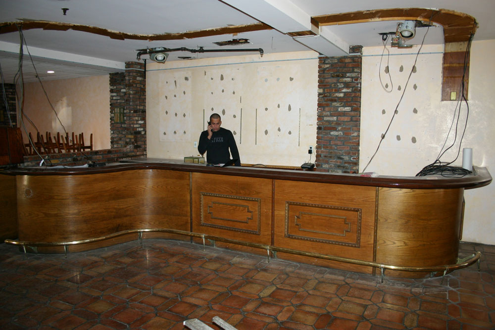

We are about to bid on a job for cabinetry for a restaurant/bar. Although the existing bar will stay, I would like to show that to the client as we propose the cabinetry that goes behind the bar. The bar is curved. I don't know how to do that in eCabinets. Can that be done in eCabs or do I have to go to a different program?
Here is what the bar looks like now.

Bill, all of what you have shown in your photo can be designed in Ecabs.
It will take some creative work using the parts editor. If you need help just holler, that's what we are all here for.

Thanks, Dave. Based on your comment, I took a quick hack at a display cube and started seeing the possibilities. I'll give a shout if I get bogged down.
