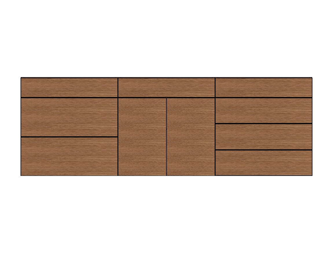

Thanks Brad for the response and PDF. I don't have, at the machine CNC experience, but obviously an experienced machine operator would undersatnd this better. In short though I understand the concept and that you say it can be done. I have attached a jpg as an example of the cabinets I am trying to apply this to.
My next question would be: If I were to send this out to a Production Sharing shop, would I do anything different in my basic eCabinet programming and how best to communicate/prep to hand over for minimal exposure to outcome error and time consumption ($) for the Production Sharing Shop?

Unfortunately, the combinations that you have illustrated in your image cannot be combined into one single grain matched entity. As noted in the PDF document, the "T" confirmation and similar layouts cannot be produced as it requires unmatched parting cuts with the outline tool. (And an 1/2" outline tool does not equate to a 1/8" gap.)
Perhaps your best bet would be to grain match large rectangles that represent the overall door/drawer area for each cabinet and then part each appropriately with a saw and an 1/8" blade.
