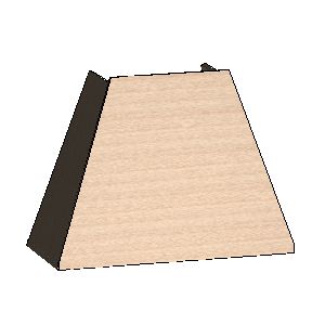

Is this what you mean?
W3612 Vent Hood.jpg (10.51 KiB) Viewed 10691 times

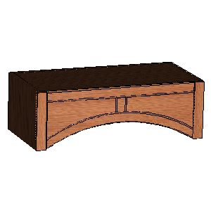

or
Hood 32.jpg (9.48 KiB) Viewed 10691 times

Tim, Hood 32.jpg is what I mean.
tony

Here is the file for it
Hood 32.hsf
(198.02 KiB) Downloaded 824 times
I just used the rotate tool and part editor to create the look of the hood - I did not cut the hood out from this file
Tim
www.TLCW.us
