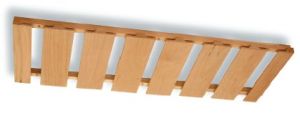

Many times George D. has created 3d items for myself and others but I would like to learn a little so...
I have searched the web for a DXF or STL file of a under cabinet wine glass rack no find :(
how would I start to create this ??
glass holder.jpg (5.05 KiB) Viewed 81101 times
Tim

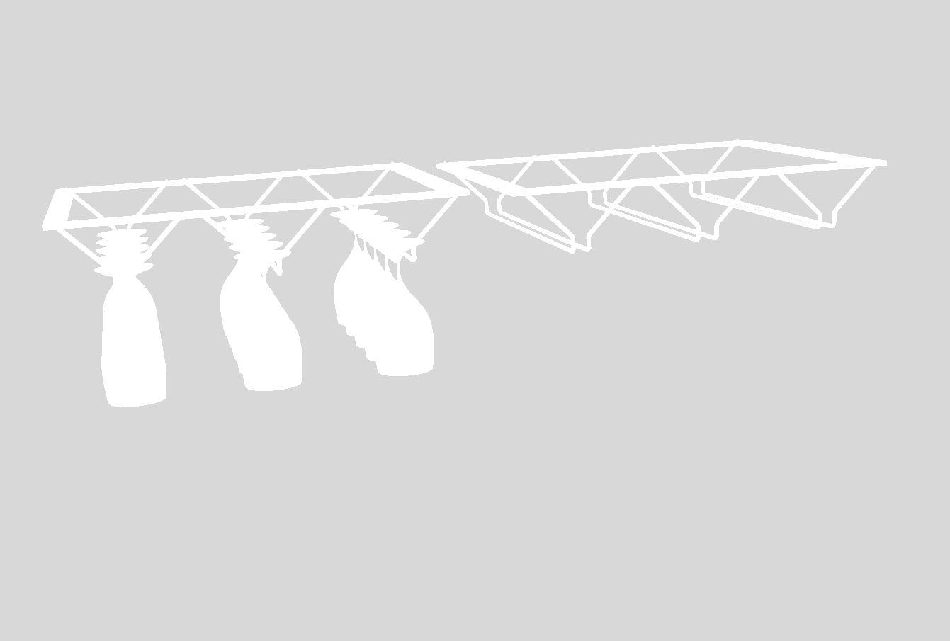

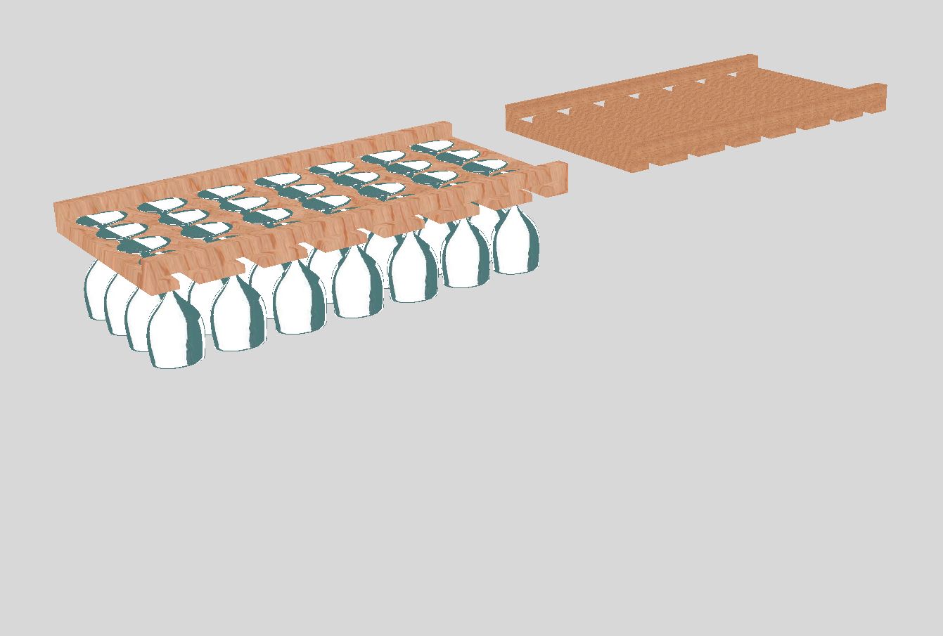

Meanwhile you are probably trying to get a quote out so I have attached one wine rack I have used and drew up your design as well. :)
wine rack1.hsf
(18.02 KiB) Downloaded 2429 times
wine rack2.hsf
(258.02 KiB) Downloaded 2471 times
wire glass rack.hsf
(24.02 KiB) Downloaded 2466 times
Re: want to create 3d item
(The rule is a maximum of 4 uploads per reply)
wine rack full.hsf
(154.02 KiB) Downloaded 2503 times

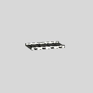

Winerack 60mm x 25mmH.tol
(9.89 KiB) Downloaded 2352 times
40 mm wine 1.jpg (3.93 KiB) Viewed 81042 times
40 mm wine 1.hsf
(474.02 KiB) Downloaded 2362 times
