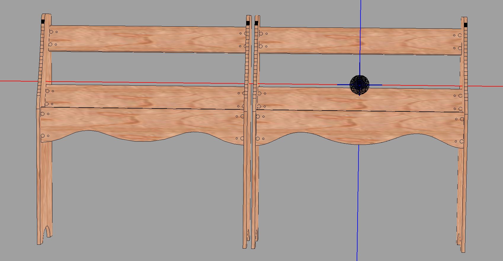

Here's a little repeat business from a customer whose job had been run successfully a little over a year ago. They've come back for some more cabs and wgen I went to load up the ones needed into batch and nested in Ecabs Link I'm getting a pocketing error. I don't know if its the curvey shape in the lower stretcher that's causing it or the Rafix SE holes. The rafix holes don't seem to be causing and issue with the other stretchers nesting so I'm beginning to think it's the Curvy design. This is odd since these parts have been run before without the nesting problem. Any help would be greatly appreciated. I've included the job file for one of the cabs.

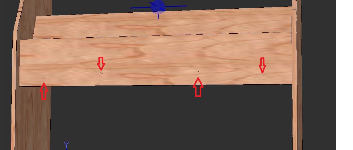

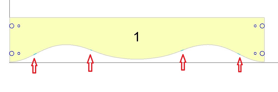

I'm not sure what happened from the first time it was ran until now, but it seems like there are four pockets added along that curve profile. See the attached pictures. In picture 1, I erased the curve cut and you can just barely see four black lines on the part. In picture two I nested in THM before erasing the cut. The blue lines represent outside boundaries of a pocket. I tried saving the geometry for the large curve, erasing the cuts, and placing it back on, but I believe it was added as a spline since it has so many line segments. Somewhere those lines are disconnected not allowing it to be selected again to make a part. You can try to trim them together and make it good again, but it will be extremely time consuming. I can't imagine it giving you a very good cut as well with so many segments.
Unfortunately I don't know how you were able to cut it the previous time. I would remove all the geometry cuts, and redraw the curves using arcs.
