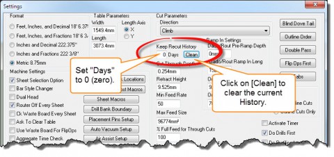

- Brad McIntosh
- Posts: 539
Re: Cnc is loading jobs slow and slow in general
I am not sure if it has been suggested yet, but...
If you are NOT using the "Recut" feature, set the "Keep Recut History" to 0 days and [Clean] the existing History file. The behind the scenes management of this HISTORY database as well as its growing size can slow things down.
It should be noted that after you load a TWD and you perform a [Nest X] or [Nest Y], Control Nesting adds the "new" information to the "Recut History" even if the job is not written to CNC.

- Brad McIntosh
- Posts: 539
Chris,
In the Control Nesting [Settings] dialog, set the "Keep Recut History" to 0 days and [Clean] the existing History file.

- Junior Member
- Posts: 69
- Joined: Tue, May 19 2015, 7:44PM
- Country: AUSTRALIA
ok we have some good news, the cnc is loading jobs remarkably faster than it was.
thanks to all of you guys. your help has been much appreciated
