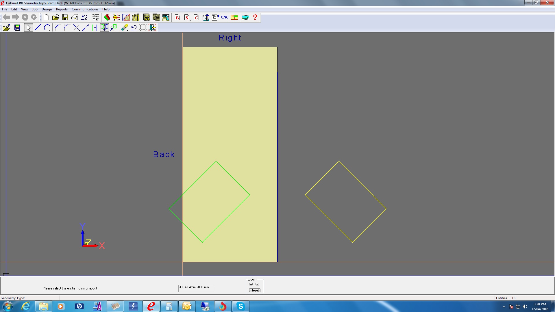

i have tried that and this is what i get, please bare in mind this is just an example and not the actual project.

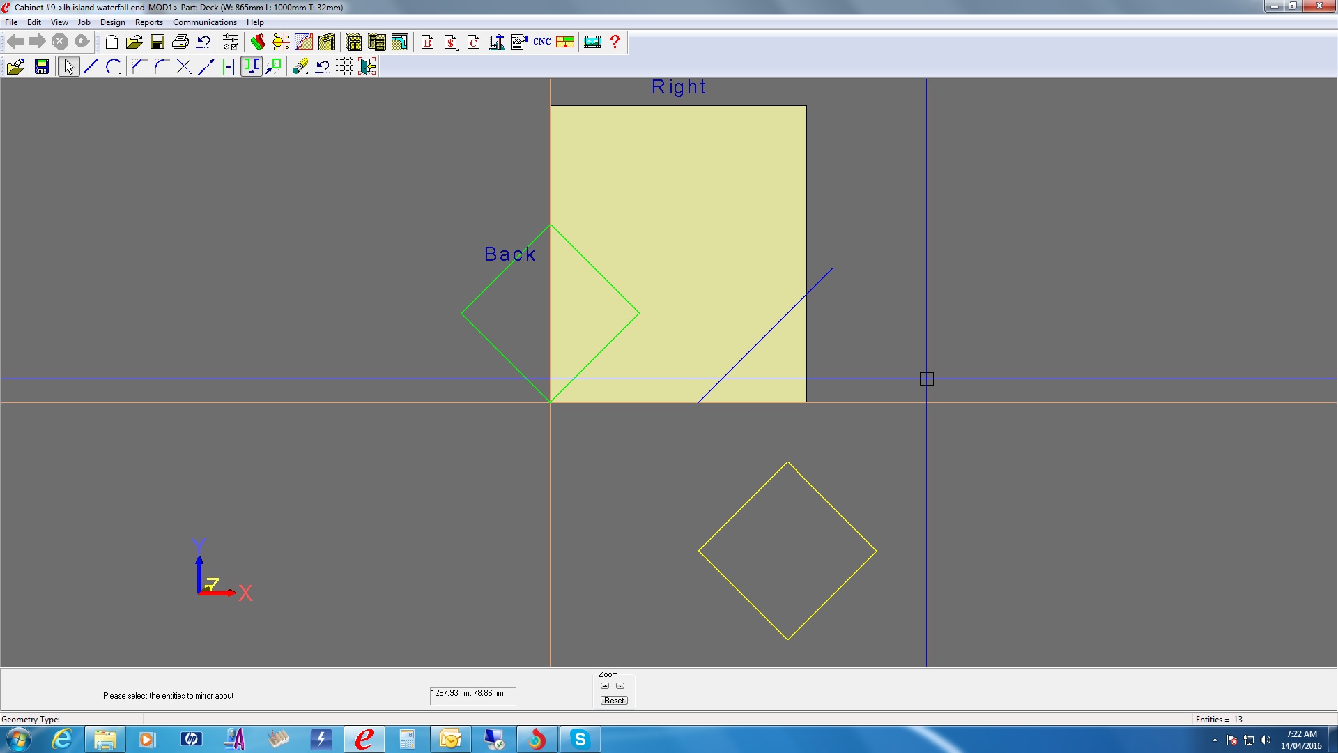

im sorry to keep bothering you, i ve done the 45 degree line and still no luck angle snap to 45 degree mirrored to line as suggest and these are the results:

Try drawing the line at 22.5 degrees and mirror to that.

You should be drawing a line to mirror about half the angle you drew your geometry. For example, if you geometry is drawn at a 45 degree angle, your line to mirror about should be drawn at 22.5 degrees. However, Contour Mode doesn't seem to be cooperating with the decimal in the angle. The vertical line should be at 90 degrees but it is measuring at 89. When the programmer is back in, I'll question if its a bug or a reason why it is like that.
In the mean time, email me the cabinet you are working with that has the geometry at an angle that you would like straight up and down to cabinets@thermwood.com and I'll see what I can do with it. Or if you have the geometry saved from Contour Mode, you can email me the x_t file it creates and I should be able to work with it as well.

the 22.5 degree line was the line i needed to use and now make sense of it.
this new knowledge will certainly come of use.
