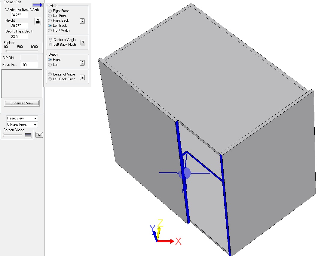

Hi,
Here I have a problem with upper and lower corner cabinet.
I do set my deck with the lock dado construction. If you look at the left back width you will it is set as 24.25'' and the right dept at 23.5''. When I do this, there is a problem with the left deck edge construction. If I put the left width at 24.5'' everything is ok.
For upper cabinet it is the same thing but with regular dado construction.
Thank you!

Good morning,
It would seem that either the software has a glich or by design it will not make a proper lock dado joint on a blind corner cabinet with the blind end being flush with the door, at least it will not fit the Dado or the KD fitting properly. It would seem that this is some thing that has been going unnoticed for some time. I have reproduced this in the beta, and the 6.1.1 release and maybe before that. Let's hope someone in the programming department might take a look at this and respond.

Audrey,
Can you send the cabinet you are working with to cabinets@thermwood.com so I can take a look at it? If it were me making a blind corner back, I probably would just use a lower cabinet and add parts as needed rather than use a corner cabinet. I haven't designed any myself with it, so there may be something I'm missing.
