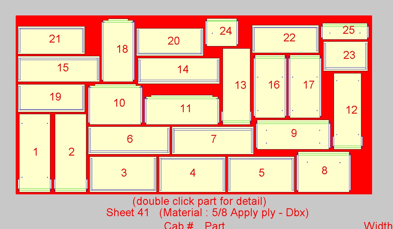

Couple of things I've noticed and was wondering if there are settings I need to adjust to change this.

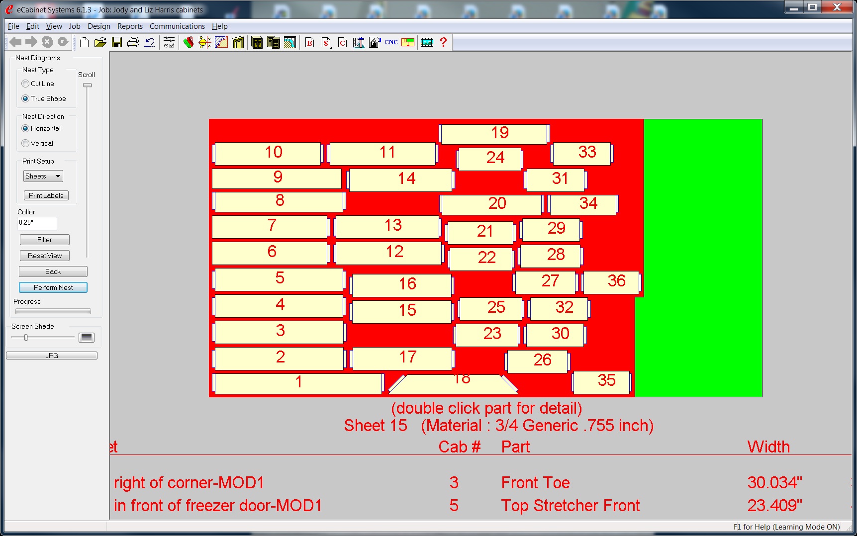

First issue is the way I'm getting some parts kinda randomly placed on the sheet. "Picture 1" and "Picture 3" shows this. Part 34 and part 35 on "Picture 1" seem to be kinda randomly placed in the midle of the sheet instead of all the way to the right of the sheet. In "Picture 3" it seems parts are just randomly placed all over resulting in a significant increase in wasted material.

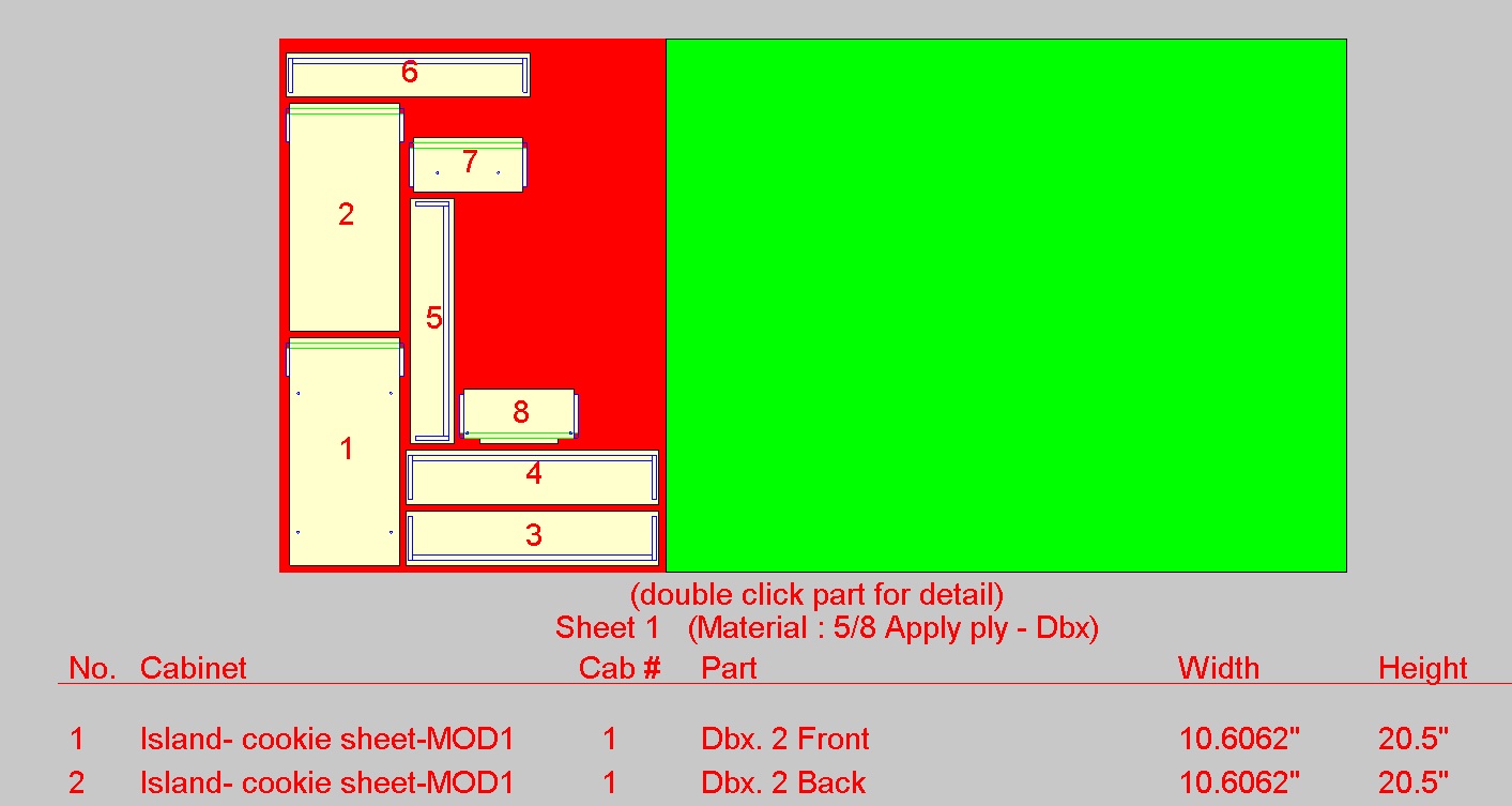

Second issue concerns some parts that don't seem to be getting laid out properly. "Picture 2" shows this. Parts 1, 2, 12, 13, 16, 17, 18 are the problem. In the drawer box editor, I have these parts set to be rotated 90 degrees. It seems that whether I set rotation for these parts to be 0 or 90, they get laid out as shown. I would like them to be laid out 90 degrees from what is shown (long way with the grain of the plywood, not cross grain). Am I using the rotate parameter in the material selection part of the drawer box parameters incorrectly?
Are there parameters that can be set/changed that would eliminate this?
