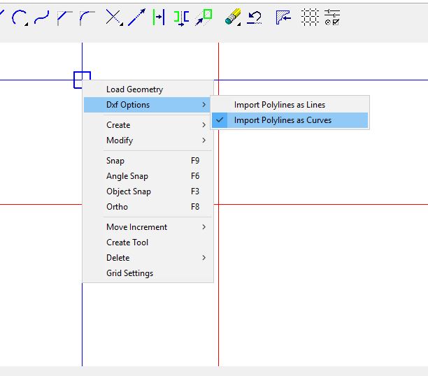

Just wondering were to find the toggle, could someone post a screen shot? Is it just when poly lines are detected?

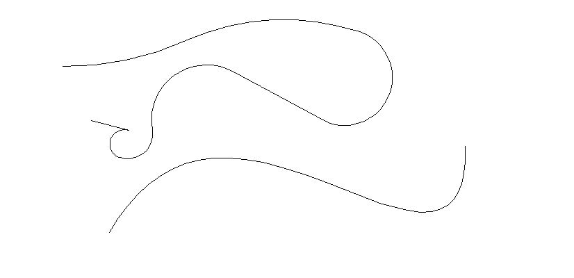

So this is the poly line I am trying to bring in, and it breaks it into short lines.

Brad McIntosh
Posts: 539
Company Name: CNC Automation
Re: Added option to import DXF polylines as lines or as arcs (Enhanced)
Post by Brad McIntosh »
The polyline has to be originally created with line and arc segments. A "spline" like you have illustrated will be broken into small lines as there are no original arc entities which define it.

Clint Buechlein
Posts: 786
Company Name: Thermwood Corp
Post by Clint Buechlein »
David Giesbrecht wrote:Just wondering were to find the toggle, could someone post a screen shot? Is it just when poly lines are detected?
It is available in two places, Contour Mode of Part Editor, and Shape Manager.

David Giesbrecht
Posts: 89
Post by David Giesbrecht »
Thanks Brad and Clint. Also Ecabinets, great feature. The top one was a poly line the bottom was a spline.
