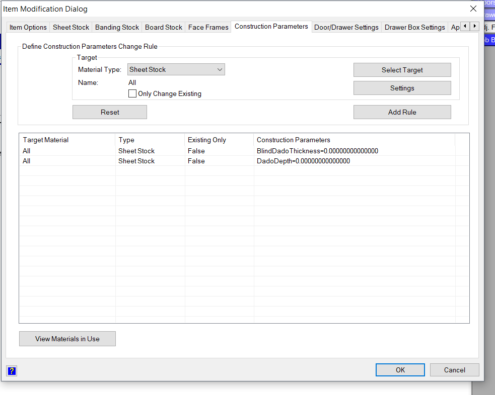

I found a bug in global item modification -----> construction parameters
when you type in a number for eg. blind dado thickness or depth and then add the rule it changes it into 0.000000000000000
seems to be a metric only issue

Thomas strembitsky wrote:I found a bug in global item modification -----> construction parameters
Thomas,
I see the same thing here, I'll pass it along to the software engineers. Thank you.
