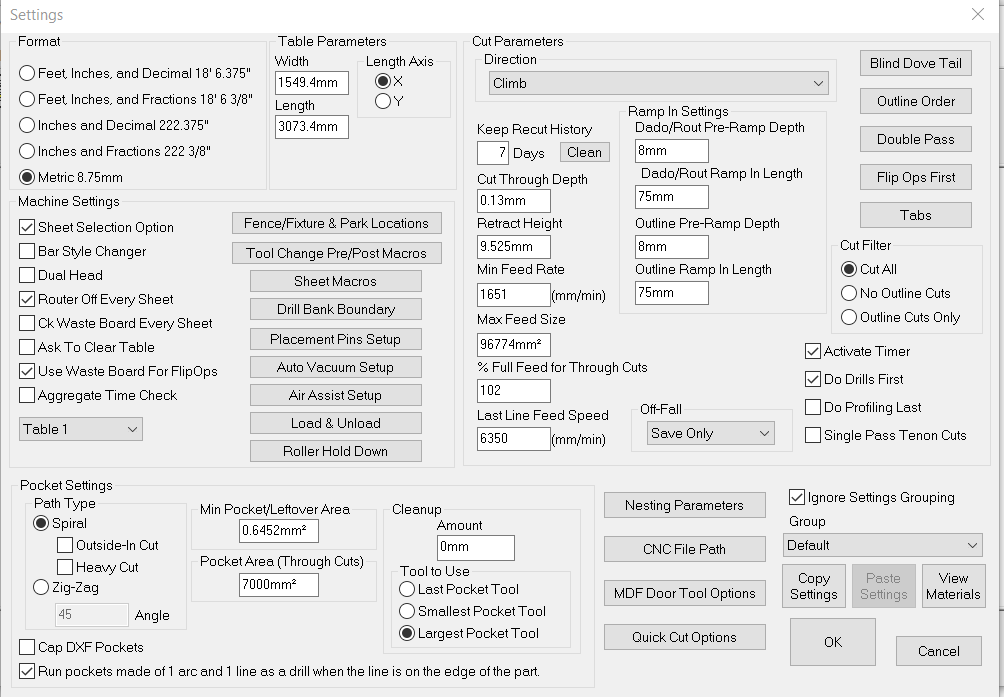

Tommy Wieler
- Posts: 124
- Joined: Fri, Sep 22 2017, 7:49AM
Re: Ramp for pockets
We also use a flycutter type tool for pocketing on mdf shaker style doors, and we were able to lengthen the tool's ramp-in length by changing the rout/dado length setting
Below are our tooling settings for the pocketing tool.
