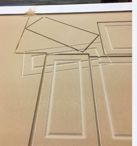

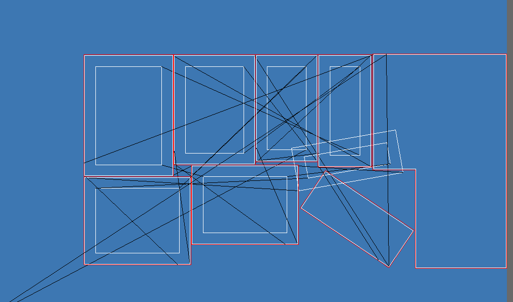

cutting some doors and I rotated a piece and it added another piece that was also rotated
please see attached pictures.... ive never seen this before.
this is with nesting from the lower left
when you rotate a part it looks like its operations don't get moved along with it

Same problem here, although in my case the model always stays put exactly where Control Nesting originally nested it. If I move or rotate the part, the model stays behind, everything else moves.

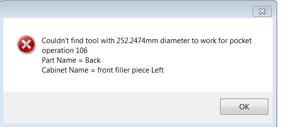

its looking for a 1/4 or 3/8 downshear

Thomas strembitsky wrote:cutting some doors and I rotated a piece and it added another piece that was also rotated
I see the same here and have it listed to be looked at by the software engineers.
Thomas strembitsky wrote:its not my fault when things don't work how they are supposed to. I think blaming the operator is pretty low... thermwood needs to spend more time with testing out the new features , because being stuck with a bug for months on end gets old fast. why don't they offer a beta branch like they do with ecabinets so this can get fixed while its in active development?
I still find bugs like this which is sad
Do you have job on that you can get this error message with? If so can post an export from Control Nesting? I will most likely also need the .twd as well as the actual eCabinets job (if it is an eCabinets job).
