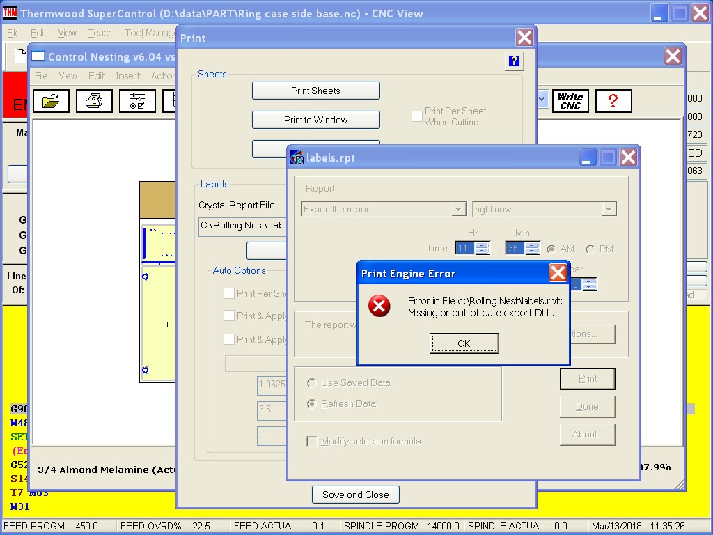

Getting an error this morning (Error in file c:\Rolling Nest\Labels.rpt: Missing or out-of-date export DLL.

Can you post a screenshot of the error? When exactly are you getting the error? When opening Control Nesting, when printing labels, during the CNC file running? Is this on the machine or on a Desktop Edition of THM?

I get the error when I click on print on the labels screen, this is on the machine.

Just looking at my own screen capture and I found the problem, reports some how got set to export and not the printer the way it should be, works fine now!

that has happened to me before as well, sometimes you bump the scroll wheel and it selects a different option

Just out of curiosity I tried the export option at the machine and the desktop version. Both display the error. Never use export but there does seem to be a problem there.

David Egnoski wrote:Just out of curiosity I tried the export option at the machine and the desktop version. Both display the error. Never use export but there does seem to be a problem there.
We are aware of the issue, just haven't made it there. The export option is Window's way of creating a PDF. There are other options available to create PDFs that are simple enough so it hasn't been bumped to the top of the list yet.
