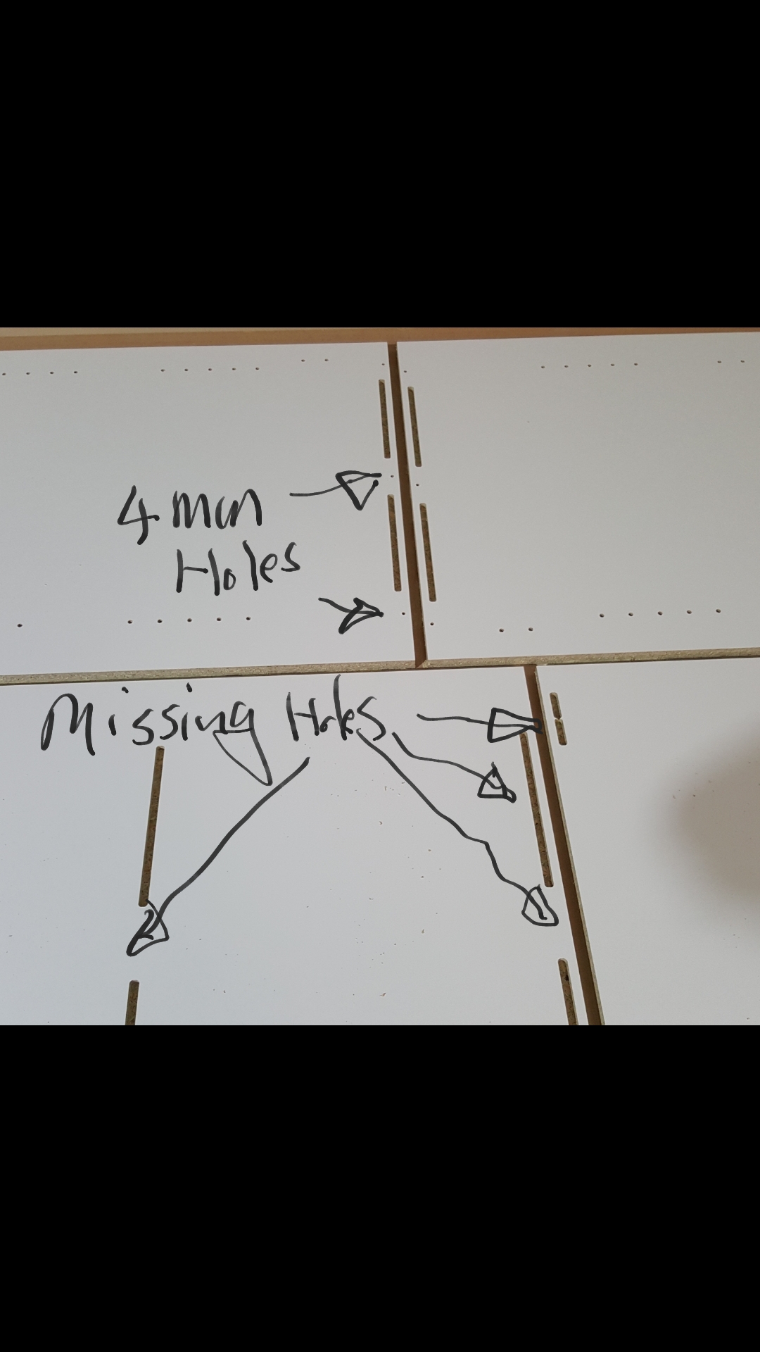

The other questions is, we just cut up a job including lock dados. The lock dados we have made up include a blind dado and just a 4mm screw hole in between the dados. We do have a 4mm drill in our tool group, so that's why some of them are working.
For an unknown reason, the holes just did not get drilled on some of the pieces in this job. Some of them did get drilled.
We have used this pattern before with no problems, and the pattern is definitely applied to the cabinets.
There was also some 4mm handle holes that didn't all get drilled either, but some of those did. it seems very random.
This job file is attached as is a picture of the missing holes.

For your first question regarding the 5mm drill, make sure the 5mm drill is in the operation list before the 3.18 mm cutter. In general your tools should be ordered from largest to smallest. Control Nesting starts at operation 1 in Tooling and checks to operation 50. As soon as the Control Nesting finds a tool that can do the job it stops looking. It does not find the "best" tool to do the job, just the first it finds.
To answer your second question, I'd need a few files. The first would be an export from Control Nesting, and the other is the actual CNC code created for the parts pictured above. You can create an export by opening Control Nesting, making sure the problem job is loaded, choose File, and then Export. The next dialog is asking where you want to save the export. Choose the location, follow the prompts, and email the export in with the code.

Quote "The two cabinets that have an issue have lost their hole patterns somehow. By copying the center cabinet and pasting it, returning to batch keeping changes, returning back to cabinet editor and rebuilding the newly pasted cabinet I can get it to lose hole patterns as well. However, what I cannot do is get eCabinets to do it from scratch. What is your exact step by step process to creating an assembly like that? I we can reproduce it from a standard cabinet we can correct the issue, but we need to know how to get to that point.
Clint
And
When I regenerate these the two cabinets in the attached screenshot with red arrows pointing to them, they lose all hole patterns. I've sent the cabinets to the software engineers to see as to why that is happening. If you send the cabinets to CNC as they sit in the job, all the holes stay. But if you regenerate them in any way, including changing material thickness on the way to CNC, the holes disappear.
I'll let you know as soon as I hear from the software engineers." Quote
