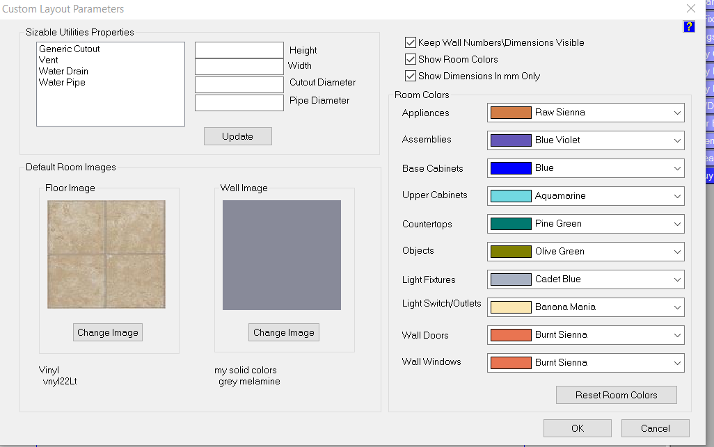

Hi Neville! If you right-click in the custom layout and click Custom Layout Parameters, there is a checkbox for "Show Dimensions in MM Only"... that was pretty recently added. This applies to the Custom Layout and the Line Drawing areas. It then won't display large dimensions in meters.

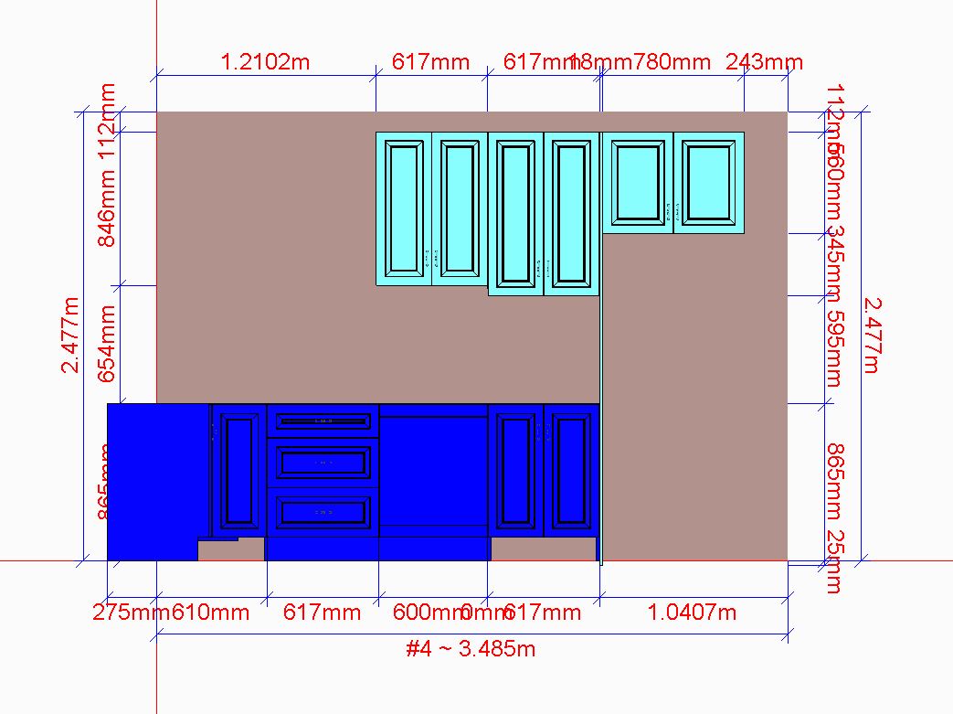

Just a question is anyone else getting the error as in the drawing below? The 1.0407 should read 1040 and the 1.2102 should read 1210
I think it is including the rounding as well.

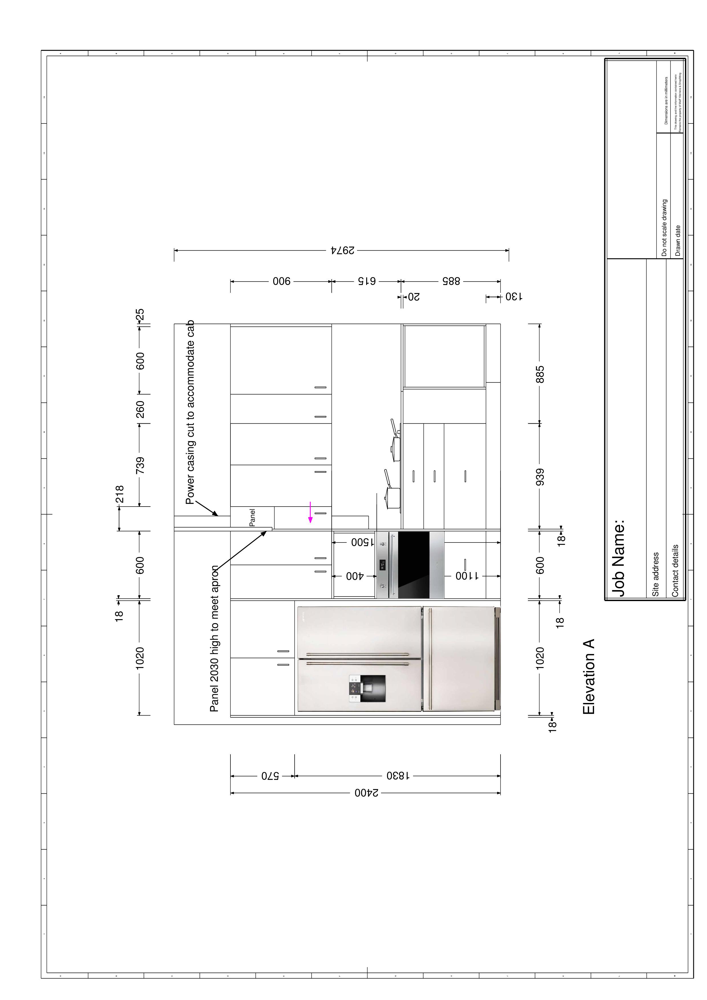

Below is the type of drawing we put into the shop at the moment, Its a lot of drawing time and yet on custom stuff it really helps to cut down on errors.
Clear easy to read drawings save money

There is no need for mm or m symbols and no need for coma's or decimal points for anything over a meter.

I cant help with getting rid of decimals but inside the custom layout area if you right click and go to custom layout parameters you can check a box to have it show dimension in mm only

For metric users though, if I was using meters it still reads wrong.
If you wish to display comas, 12102 should be 1210.2 or even 1,210.2

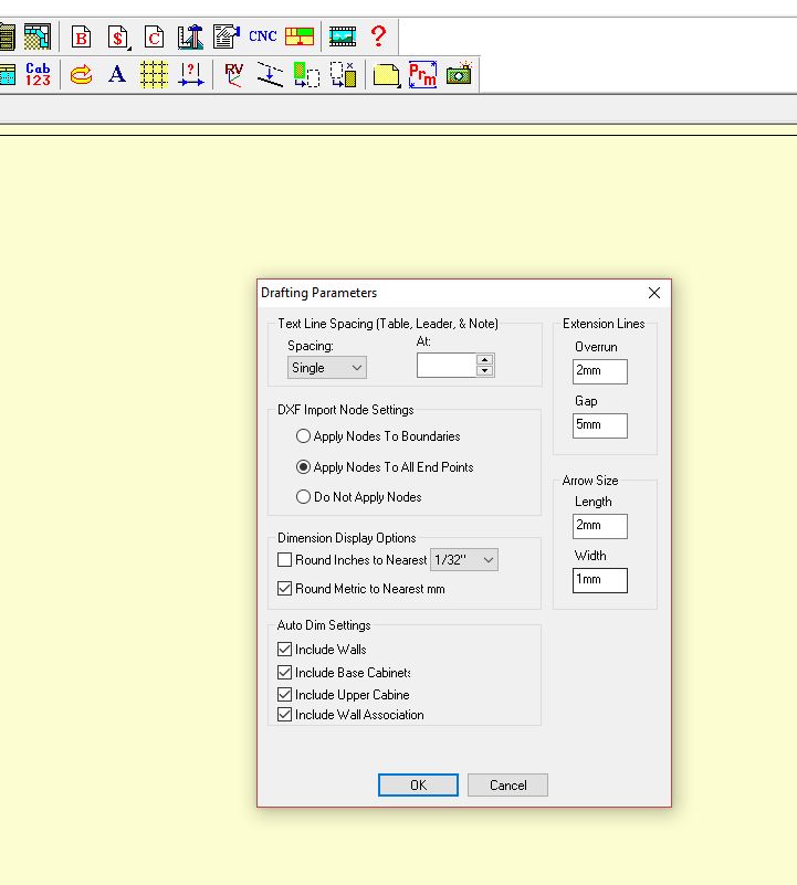

Perhaps its a default setting depending on which version of windows we are using? The only settings I can think of that affect arrows, is in the line drawing editor as per the above image
