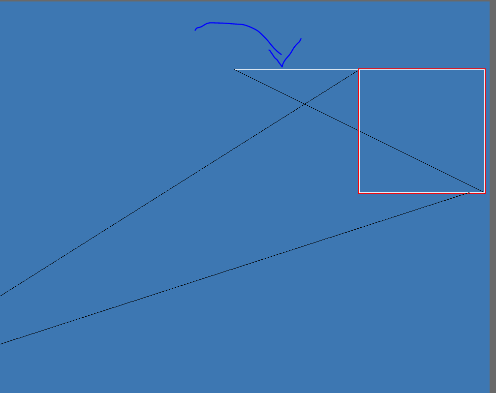

in ecabinets create a part that has grain and apply a profiled edge to one edge
nest that part and rotate it 180 degrees and nest. look the graph screen and you can see the profiled edge is no longer attached the part.
please see attached picture and I can make a video demonstrating this as well.
seem similar to the issue I was having before with the door profiles not staying attached when getting rotated.

Thank you Thomas. We are able to reproduce the issue. We will get it fixed.
