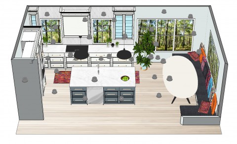

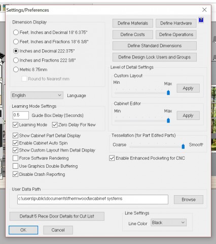

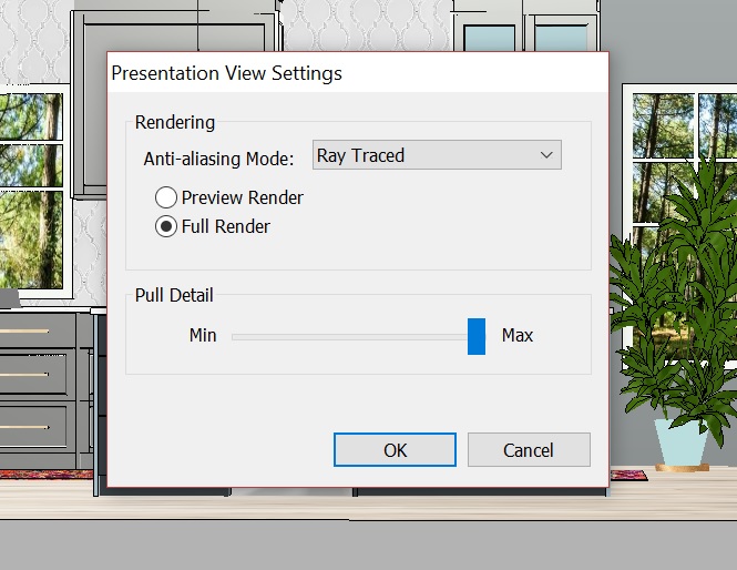

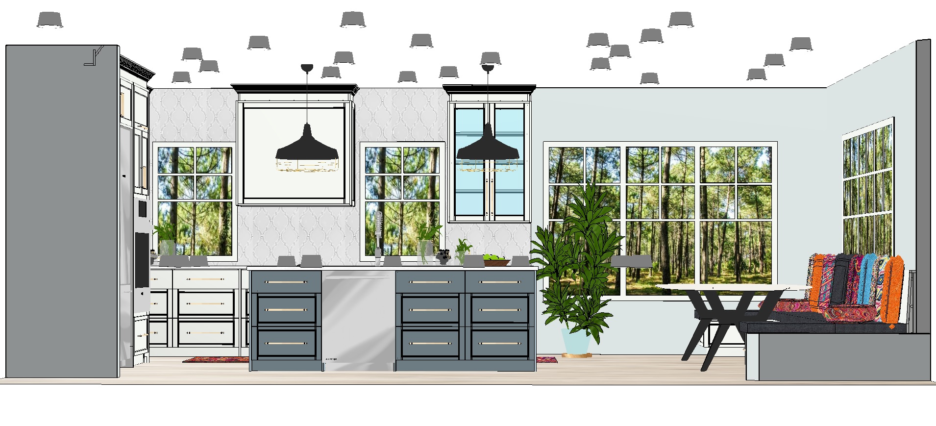

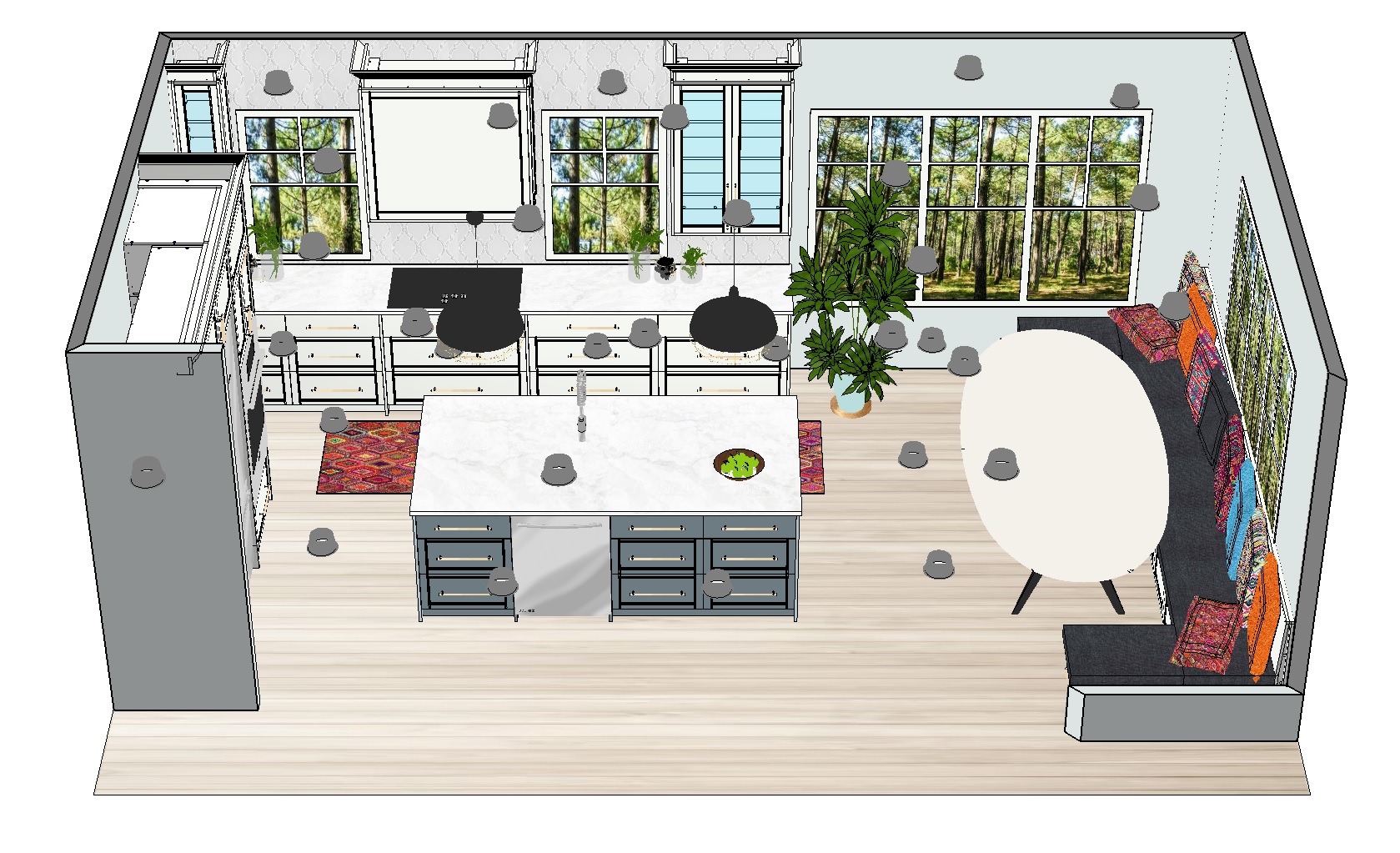

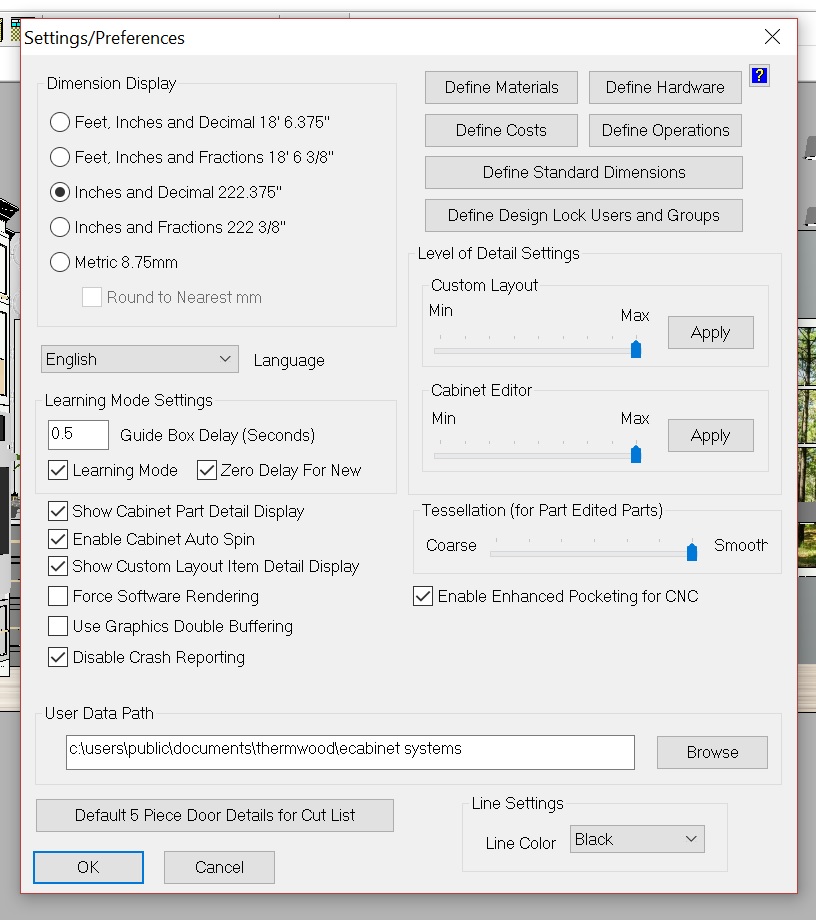

Here are pictures of the settings. I tried it again with a simple cabinet but here is my project.
