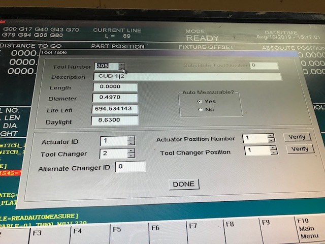

Have you assigned a number in your tool actuator position,,,usually "1"

Yes Ian
Tools are assigned but it seems that the machine doesnt recognize it
