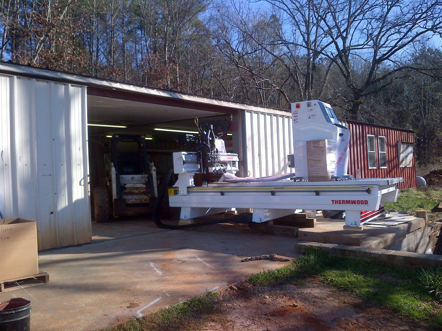

Aaaaand for fun, here is our CS-45 5x12 machine on our dock just after we got it pulled out of the semi trailer. As you can see, our shop has a low ceiling. We have to remove the controller from the table to get it thru the door. See the Bobcat inside the shop, that was used to pull it off the trailer, and eventually into the shop. Once there, we were able to maneuver it into position with 2 pallet jacks. Just take it slow and easy, and pre-plan each movement, and it will go fine. Leverage and balance are your friends...

Looking forward to some install photos like Jeremys Bobcat. He is only showing that ,now its out of warranty.
