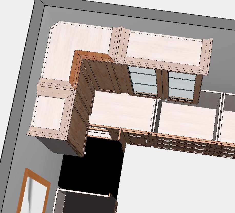

I have a corner cabinet when I modify texture of the crown molding the side moldings change but not the front sections
i tried 2 different moldings with the same effect

Re: Modify texture in render mode corner cabinet
I usually highlite the crown and select Match Texture and click on the color I want.
Tim,
I see the same thing here. I'll let the software engineers know so they can take a look at it.
