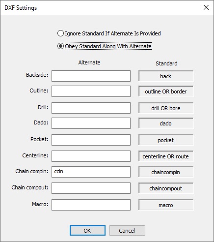

Dave,
What version of Control Nesting are you on?
Clint Buechlein
Posts: 780
Company Name: Thermwood Corp
Re: What CAD software do you use to create DXF files for Control Nesting?
Post by Clint Buechlein »
My reason for asking, as of version 6.12 your are able to designate alternative names for DXF layers. For example, instead of chaincompin, you can name it ccin. That will take you from 11 characters to four, hopefully getting you under the character limit. There is an option within the dialog to allow only the alternative, or if you have previous DXFs you are still using, it can obey original and alternative names.

David Hall
Posts: 593
Location: Stamford, CT USA
Post by David Hall »
BRILLIANT!
Thanks Clint, I'll be upgrading asap.
