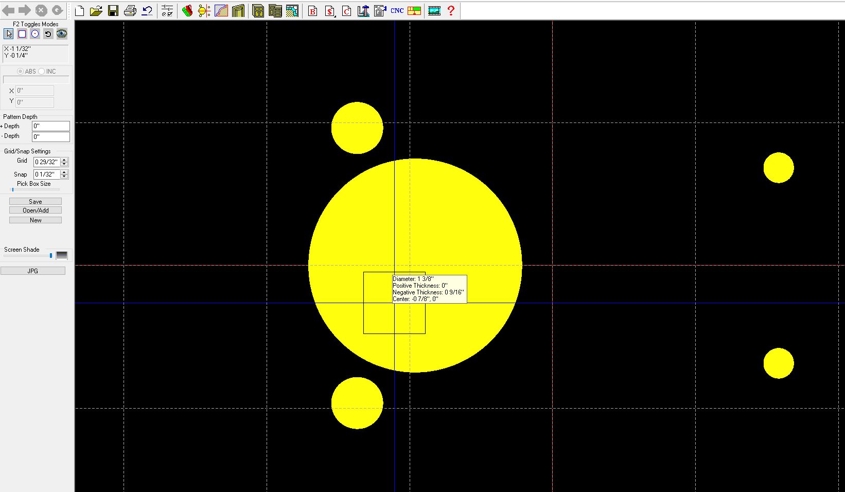

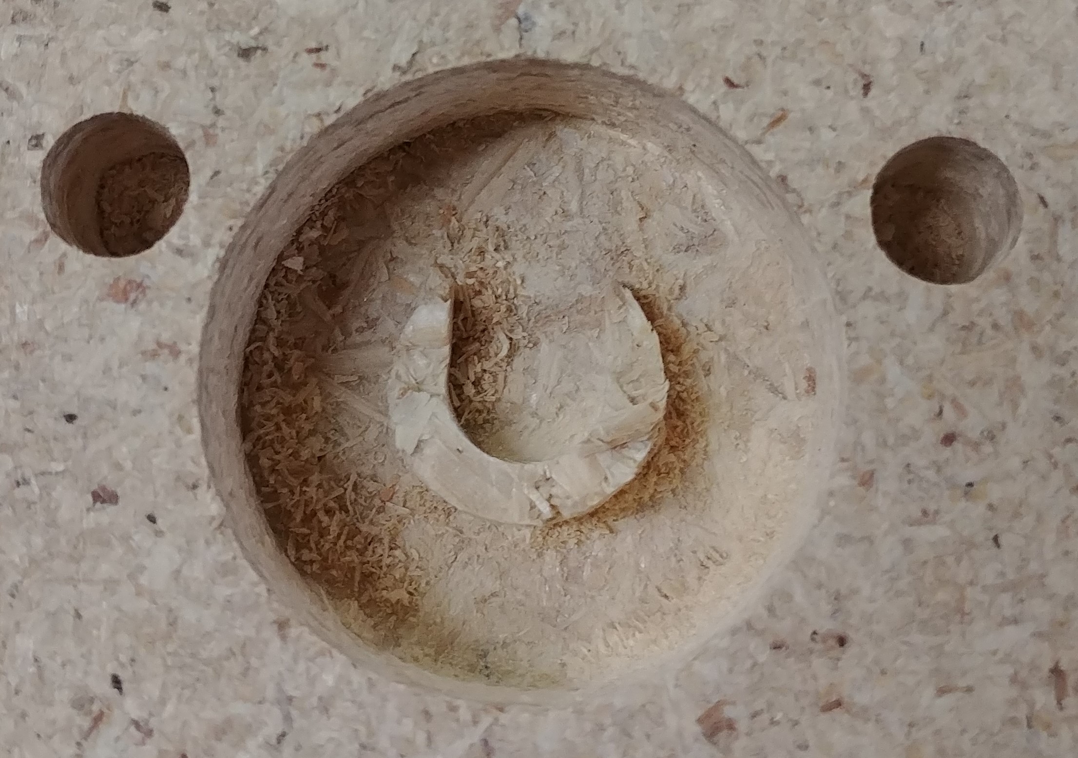

Hinge Cup (see attached picture): Where can I go to learn more about this issue? I have a standard hole pattern, but for whatever reason it doesn't mill out the entire hole. 1-3/8" Diameter Hole, 9/16" deep.

for your hinge cup issue on control nesting click on the drill bit icon "tooling" and go to the tool you use for pocketing and click the check box for interpolate. this will allow you to use a smaller tool cut a hole bigger then the tool size. also check if pocket is checked off.

If Control Nesting has not found a TRUE drill with a MATCHING diameter to machine the hole, it will then look for a tool that can INTERPOLATE and has a MAX DIA equal to or larger than the target hole. If no appropriate tool is available to INTERPOLATE, Control Nesting will then attempt to use the tools flagged for POCKETING.
The important thing with the MAX DIA associated to the tool with INTERPOLATION flagged is that it should never exceed "three times the tool's diameter". (And it the tool can be sharpened, then use "three times the tool's smallest sharpened diameter" to be safe.)
As you may know, INTERPOLATION is: Plunge at center; shift to edge (with comp); cut circle; shift back to center; retract. This is why the "MAX DIA < 3x TOOL_DIA" rule is recommended.

@ Thomas - Thank you for the Drawer Depth tip, makes total sense! That will save a lot of time. I've checked the control nesting settings and they are already activated.
@ Brad - Thanks for the information, I'll have to investigate further as my CNC machining skills are less than my E-Cabinet skills atm. For the time being, we'll transition to using a Blum Mini-Press.
