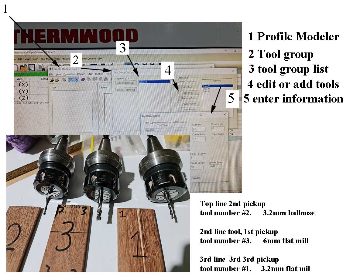

So having said that see the attached for how I set my tooling in the profile modeler up.
Its been a while since I set it up so I have forgotten some of the reasoning.
But I think it picks up the 6mm cutter first for roughing, ( So there must be some code to ask it to bulk remove material first) the ball nose second for trimming up after the 6mm roughing,(about a 5 to 15% step-over depending on time and finish considerations) (tools 2 and 3 can run quite fast because they are not removing much material) and the third pickup, 3.2mm for sharp base corners after the ball nose profiling, So in the regular tooling setup, Where all the tools are listed, I named those tools. tool 1, 2, and 3. I keep them in tool holder positions 1, 2, and 3,
