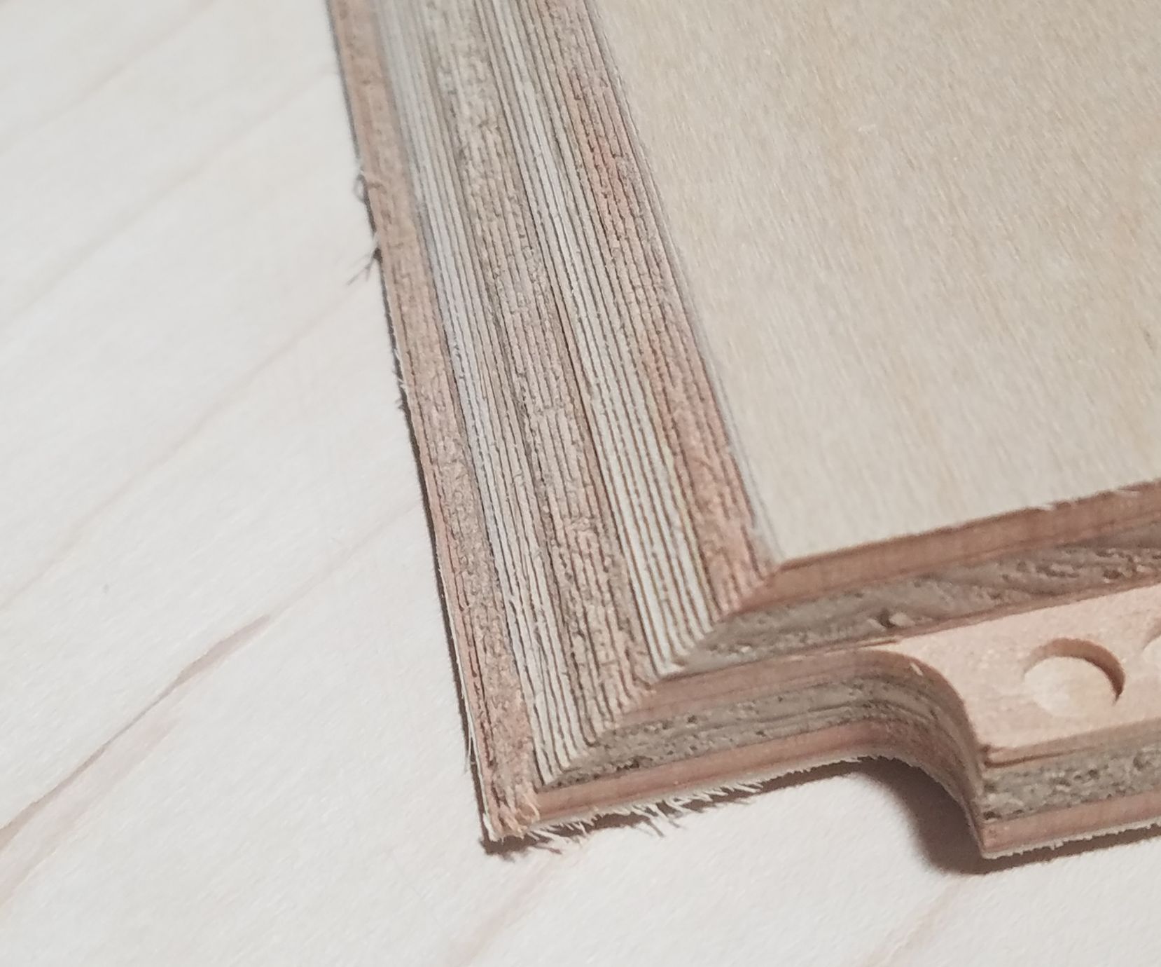

Re: Do you cut beveled edges?
Gene,
Here is a picture of some 1/2" Baltic Birch Drawer parts for a Blum corner cabinet we cut this morning.
The step was .03125"
Be sure to use a down-cut bit. An upcut or compression leaves a fuzz that must be sanded.
The "Steps" in the cut make a good glue joint.
We will be cutting some other 3/4" materials today. I will post pictures of those cuts.

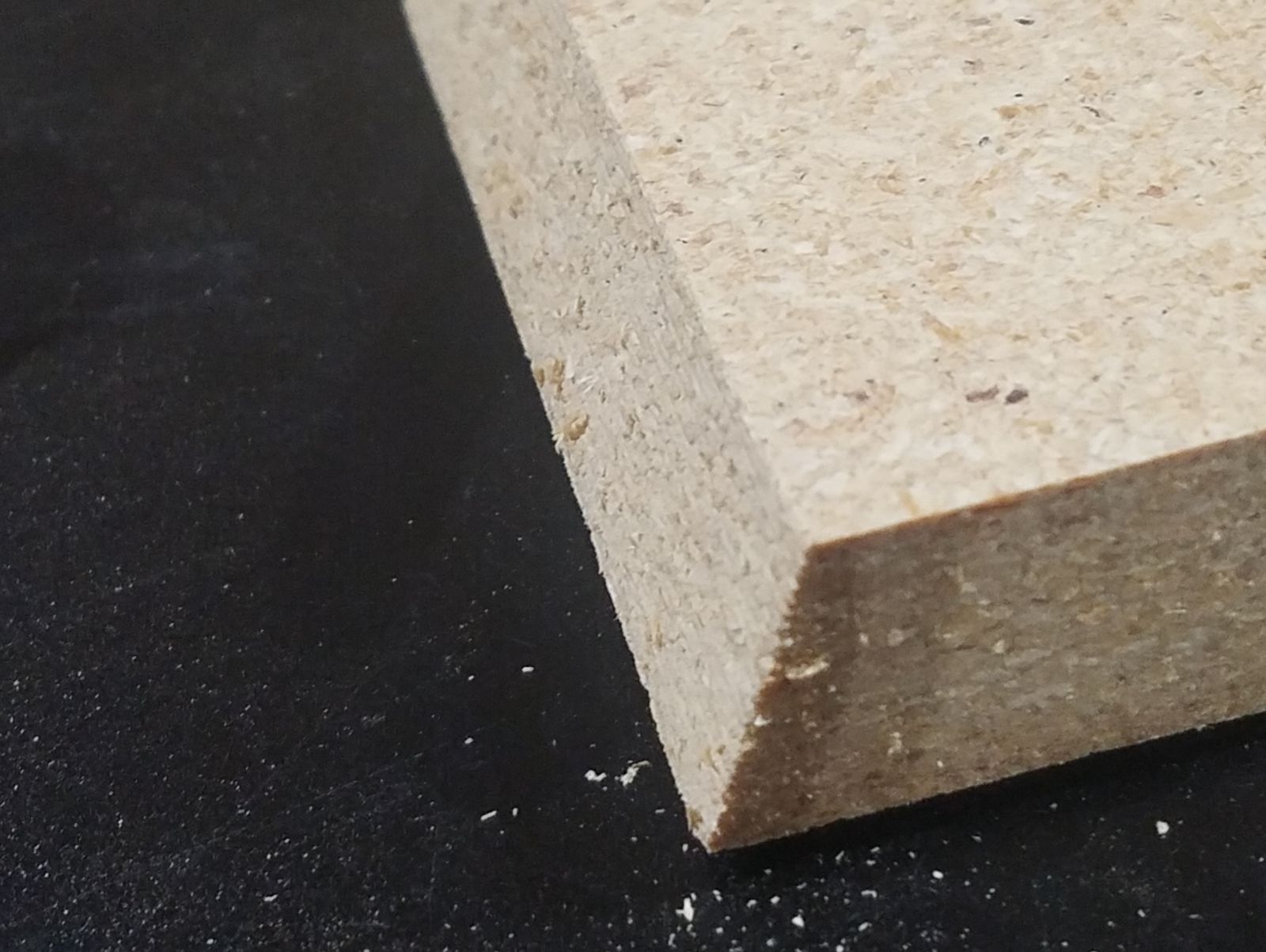

Here is a picture of a 22.5-degree bevel with 3/4" particle board for a corner cabinet back. Same tool, same nest.

What is the depth-of-step for the 22.5 degree bevel shown?
And please provide some info on the time needed to program for cutting such a bevel. Does one program serve for every part in a nest with such a bevel?
Gene,
I have the step-over in the Profile Modeler for this tool at .03125 so it will step over and down that amount for every pass. That should be approx. 24 passes for a 3/4" board.
This does take a little machine time but is offset by the fact you don't have to set up special tooling for each angle of bevel or have someone set up a table saw and make the cuts after the fact.
Yes, this one tool and setting will cut all bevels of any angle nested in the same job.
The parts are programmed in eCabinets. You create a tool to use in the part editor to create each bevel. Once the parts are created in the part editor, the shop cutting the parts will need to make the proper tool group and setup available, but Control Nesting Does the rest. They can experiment with step-over, feed speed etc. to get what works for them. Running a sample cut will get them cut time per foot for charges.
