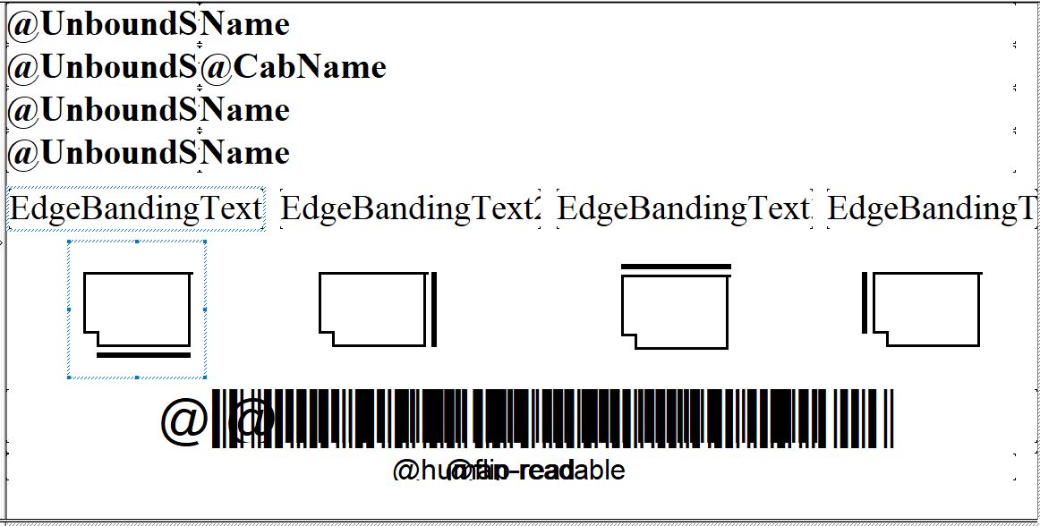

The images are identical to what they are now, you just have the option to separate into four images with the matching material text. With the standard label formats that exist in the software, there is no indicator as to which banding goes to which edge. This function allows you to have image 1 with image 1 text, then image 2 with image 2 text, etc. Attached is a 2x4 label with the four separate image and text fields. Also attached is the view from Crystal Reports. The fields are the ones surrounded in the blue hash, each a separate field. One is the image, one is text. To the right are the additional fields, one for each side of the part.
