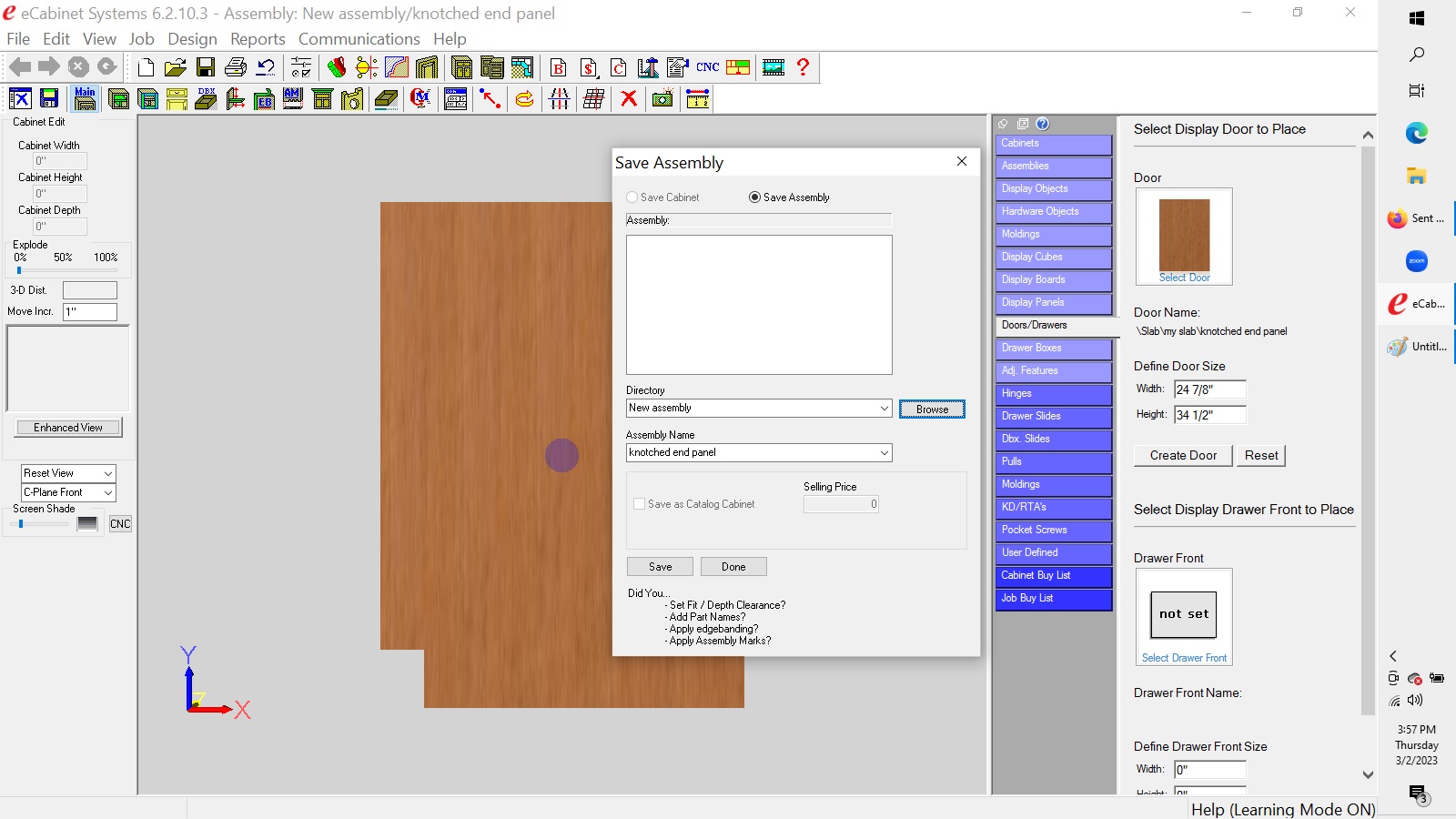

Does anyone have a trick or work around to save a PE slab door in the door directory as an end panel? I can only save as an assembly and
then attach it to the cabinet. I'd like to able to use as an Applied end but can't save to the door directory to select as an applied end panel.

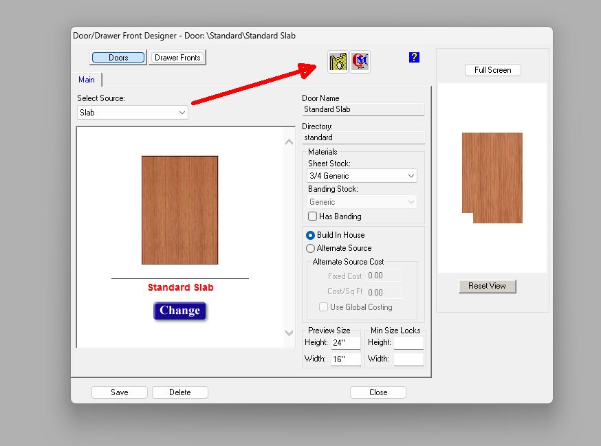

JR,
Go to the Cabinet Editor and open the Door Drawer Front Editor from there and select a slab door and you can modify it, add constraints and save it to your library. You must start from the cabinet editor.
