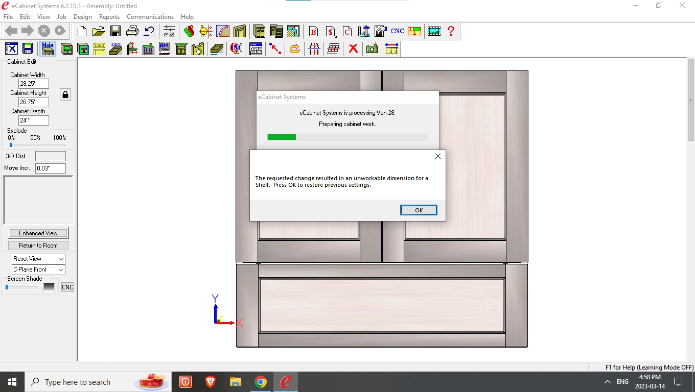

I can't seem to resize any of my cabinets. I downloaded the latest build and did a repair instalation but it didn't help. TIA Wally

Check if you have a Fixed Shelf as a Stretcher that might need the back inset formula or value changed in the construction settings. My guess without seeing the cabinet would be that changing the depth of cabinet is shrinking the Fixed Shelf to a small size that throws the error. Just my thoughts.

Thanks -- but it's not just one cabinet -- it's most of my library. I am just making a vanity so I started from scratch and made a new folder.
