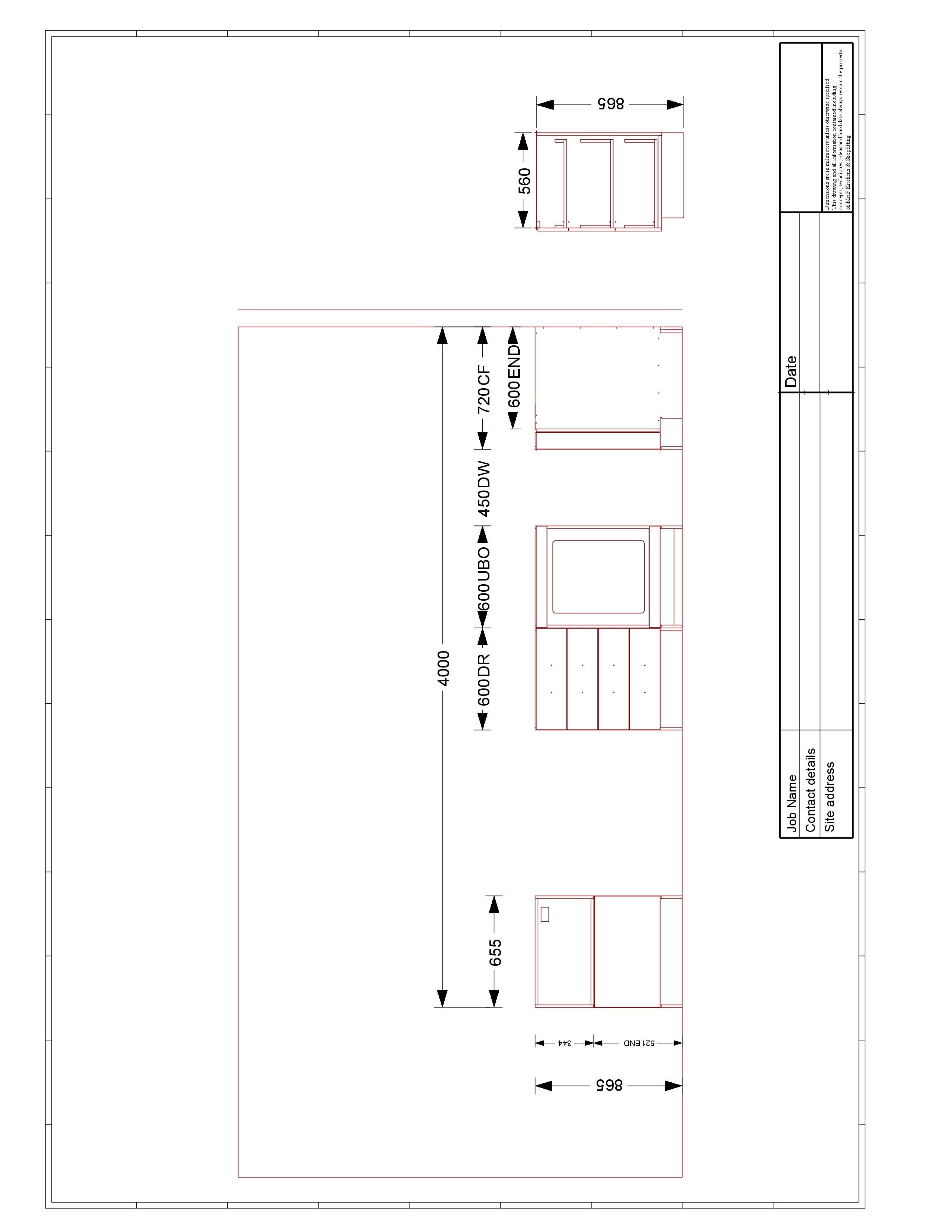

I have attached a screen shot of the sort of drawings we do. That one is one of a more detailed type of job, but we do at least a floor plan and one or two elevations generally.
Everything is drawn in one to one size. We just drag a border around the parts we want to Print or save as PDF, or turn into Jpegs to put into PDF page format in another program like MS word or one of those PDF creating programs.
Hope it helps, just my perspective, Just my two cents.

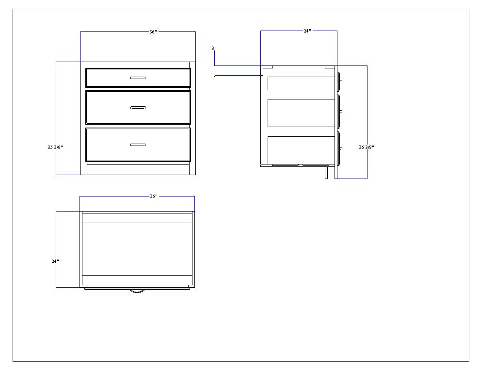

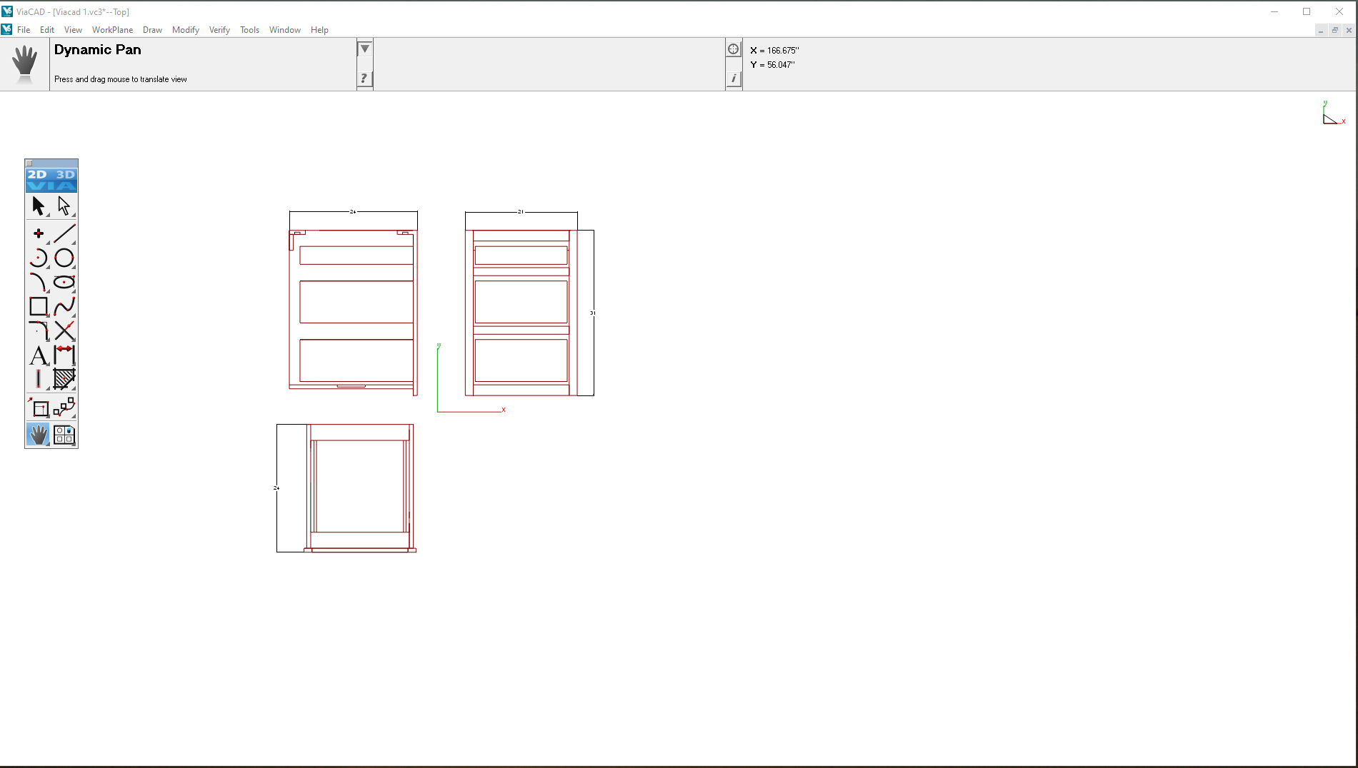

Yes, you can import elevations or plan views.
There are a couple of ways i can think of.
I will outline the cabinet one, but once you have that, you can do it from custom Layout.
1: put cabinet into cabinet / assembly editor
2: If you want internal view of shelves or drawers
In construction settings set the left or right end with a bottom inset, Say an end height of 900mm Inset 899, Just so you don't lose your drawer boxes and drawer fronts.
3: Select line drawing editor, Next to the red C in the top bar.
4: Select take cabinet .hit OK
5 In LDE use the Green select cabinet.
6: right click select rotate dialogue.
7: rotate in 90 degre increments until you get the view you want. (If if is not in the x,y, or z plane it wont export properly for me)
8: Right click again, select export to DXF.
9: save to folder.
10: In Viacad select the file menu top left, drop down, select import
11: Import type DWG/DXF. In Import type choose inches, Don't tick explode blocks, Tick the others. Hit OK
12: find where you saved the cabinet DXF to and import it.
You can now copy and drag the images around as you like.
There will be a lot of duplicate lines. I think Ecabs sort of takes an Xray picture and every line in the front and back of the cabinet gets included.
See if your version of viacad has a remove duplicates, Could be under the modeling tools, Not sure if it's an advanced feature, but even if it doesn't it still prints okay.
Sometimes I think the wall view in eCabs custom layout is easier to read than taking it to the LDE. If we could tweak a few things in there it would be good. For certain jobs just taking a screen shot of that with the windows sniping tool works well.
The attached picture was exported from eCabs and dimensioned in Viacad
Hope that helps
Hope that helps

Hi Mark,
Been working on this today, My drawing looks like yours. Cabinets have that reddish haze while the dimension lines are a sharp crisp black. When I go to print I only get the dimension lines? Am I missing something? I have been through the menu & can not find anything that would change these lines to make them printable. I tried to take the image and convert to PDF using PDF24 but it would not accept the drawing & ViaCad does not allow me to save as a .DXF or any other type of file.
Really appreciate your help with this,
Chris
Chris

Got It. Had to make a border that was 8X11 copied & pasted cabinets they were HUGE compared to border Scaled the cabinets to a .10 to fit inside border and good to go.
