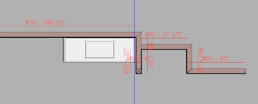

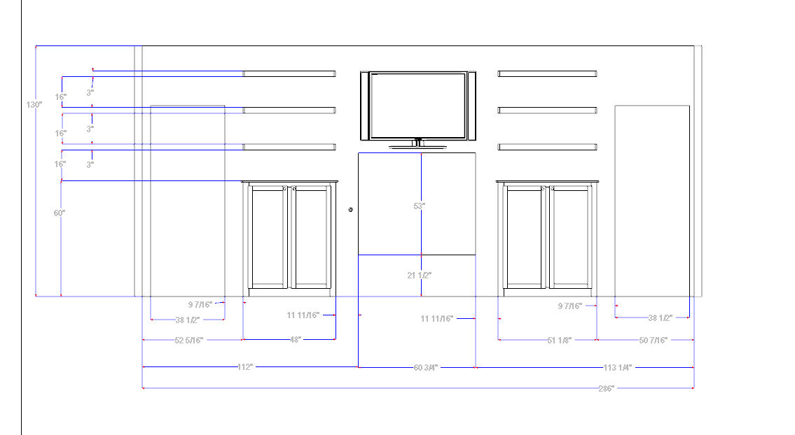

Any Idea how to fix the transparency on my text and dimensions in Custom Layout and the Line Drawing Editor?
This happened after a Windows update. I tried un-installing the update and updated NVidia drivers but haven't been able to correct the problem.
This is only affecting eCabinets, haven't noticed it any where else.
