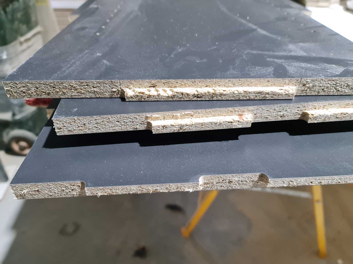

We use the lock dado joint quiet a lot and when they nest on flip ops it is quit easy to see how far out the alignment is.
There are gaps in the joint.
I have a couple of test pieces that we cut to work out which way to move it
I keep a vernier handy and measure the amount that it is out by.
So keeping in mind it cuts the flip op first you have to work out whether the machine thinks the locator pins are closer or further away and then adjust the 1st table longer or shorter or wider or narrower by the amount that it is out as read with your verniers.
I then cut another test piece and perhaps tweak it until I'm happy.
Its good to check for square 1st because that messes with flip ops as well.
I put a cover or waste sheet on and cut two 1180mm squares, mark x and y put a mark in one corner and flip one over so they are face to face line up the y side and see if there is any variation, it will always cut parallel but could be cutting rhomboids.
It will be out of square by half the distance of the variation.
Adjust and re-cut the squares down to 1170 test again.
Anyway hope that makes sense :?
