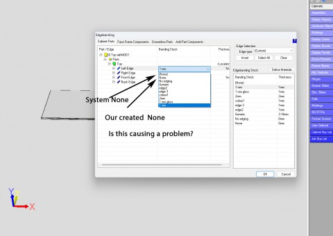

I had a random thought on this.
Check to see if all your edging materials have an image assigned to it.
I had named a material for edge tape called none with a zero thickness.
Somehow it lost it's image as in the picture.
(I reloaded it from another job that I knew had it on it to show you.)
I have now deleted that material from my edging list.
I have created another material called no edging to replace it.
Now when I load a previously designed cabinet with none edging, I replace it with no edging which has an image.
I haven't worked out if it was the problem or not. But worth a look at.
Also in the image below, There is the system None and the created None available as a edge banding selection.
I think the system None was added in after we had made cabinets using a material called None, but I cant fully recall if that was so.
I have attached a single piece that only has 1mm edging on it.
When you first load the piece into the cabinet editor, it it asks to add the edging material None.
B Top tall.hsf
(492.02 KiB) Downloaded 574 times
(the designated drawers are 1mm edging, The doors, no edging ) But the default drawer front if you check it in the door / drawer editor it wont load, because it comes up with the error message, image not found. There appears to be nothing wrong with it until you load the the default drawer front.
So perhaps look into those assigned selections and see if they are giving you problems.
I'm not sure if theses ramblings are of any help, but maybe you might find something that helps.
