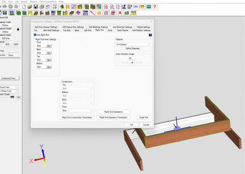

Re: Profile edge problems
Hi Forrest and Clint
Not sure if it helps.
It seems to work on a frameless base unit.
Forrest, you could use the rotate cabinet if you needed to display it.
I used your .tol tool to apply the bead. I couldn't rotate the tool to apply the smaller groove.
(I seem to remember that clicking on the left or right or top and bottom of the edge of the part is supposed to flip the way that a asymmetrical tool is applied?
That may be a faulty memory but I think it used to? It never seems to work for me so I generally just draw another tool)

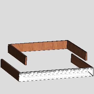

I also changed the grain direction after applying the bead to both Donald's unit and mine,....... and that broke the moldings that had been applied, some stayed most disappeared, so that could be a glitch?
(i just noticed that the windowss sniping tool can now record your screen as you do things, how cool is that!
Now every post can be a movie! Yay! :roll: )
So I made a "short" video [youtube]https://youtu.be/UdZ5K0M01AI[/youtube] using the sniping tool in windows if you want to see that.
Units before grain direction change
