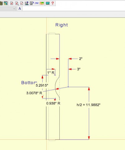

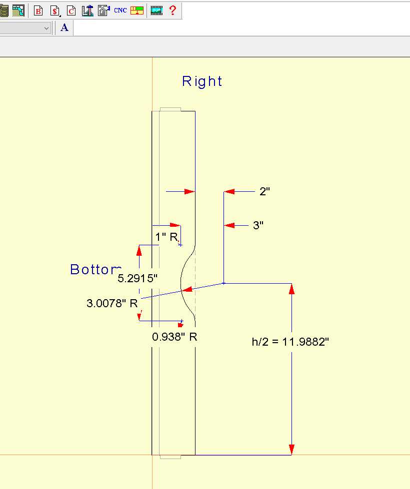

I have designed a dbox with a profiled top edge on the front (hand scoop) but when I try to unify the geometry as a set, I cannot select any of my geometry to include in it. Is this by design, for the dbox editor?

Is anyone else able to do this? Not sure what I'm missing in this process.

Stuart,
Are you trying to include the scoop cut itself in the set? If so, that is not allowed. You can group the two smaller holes together, then constrain them relative to the scoop cut. The scoop cut itself is part of the outline so it doesn't function with sets.
