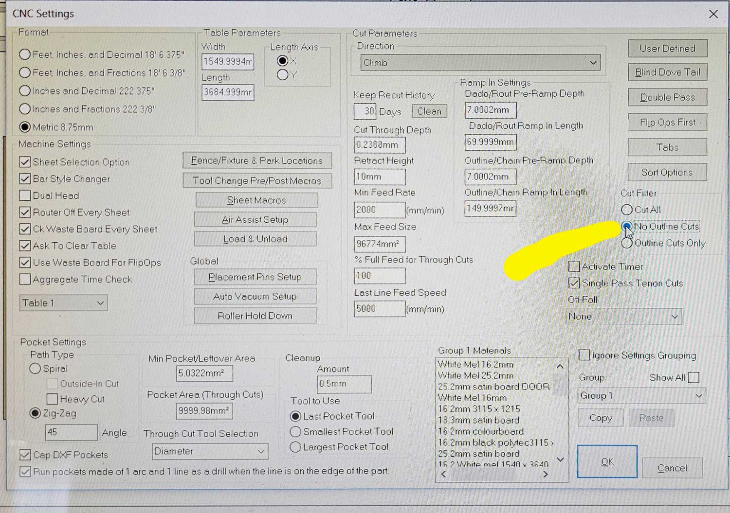

I have a bunch of 1.5" butcher block tops I want to cut the sink cutouts (& save for cutting blocks), and then I have 4 cut outs for tie bolt fasteners. The tops will be cut to size so I would like to locate the material on the table and have router do it's thing without wanting to cut the outline of the top.
I just cant figure out how to eliminate this last step other than stopping the router before it goes to cut the outline.

Hi Chris
If your setup is similar to mine.
In control nesting under the CNC settings tab "Cut all" is probably selected.
Change it to "no outline cut"s for the group that you put that material into and nest it with those settings.

Thank You Mark,
Right in my face the whole time.
