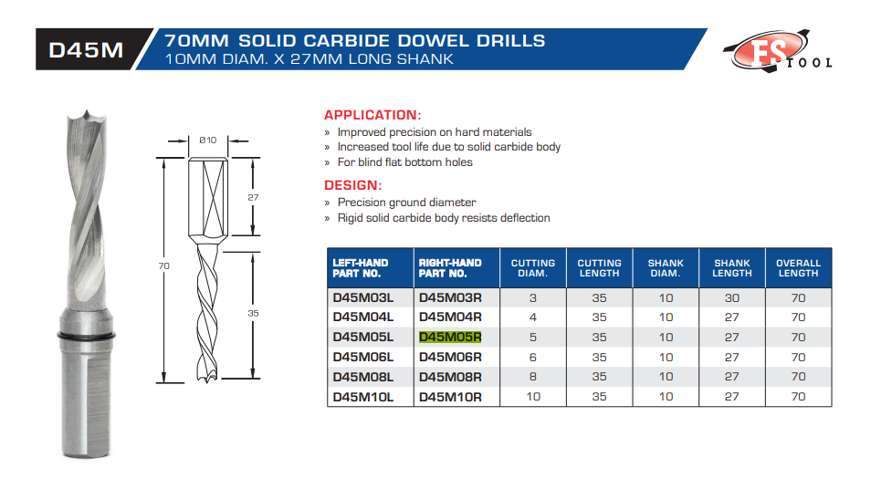

Thomas strembitsky
- Posts: 306
Re: Door handles holes
we use this from FS tools with a small break thru amount
