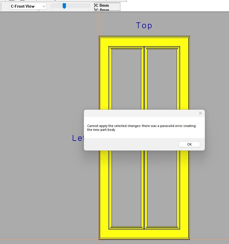

Having said that and told you how I would do it, I find the door designer a bit unstable and subject to bugs.
For one example, The door I just designed, If I go back into the door editor and take it back into the part editor I get the following error message
And all the profile edges disappear.
There are other bugs in there as well but reproducing them is the hard part,
but If you don't change anything, you should be okay.
