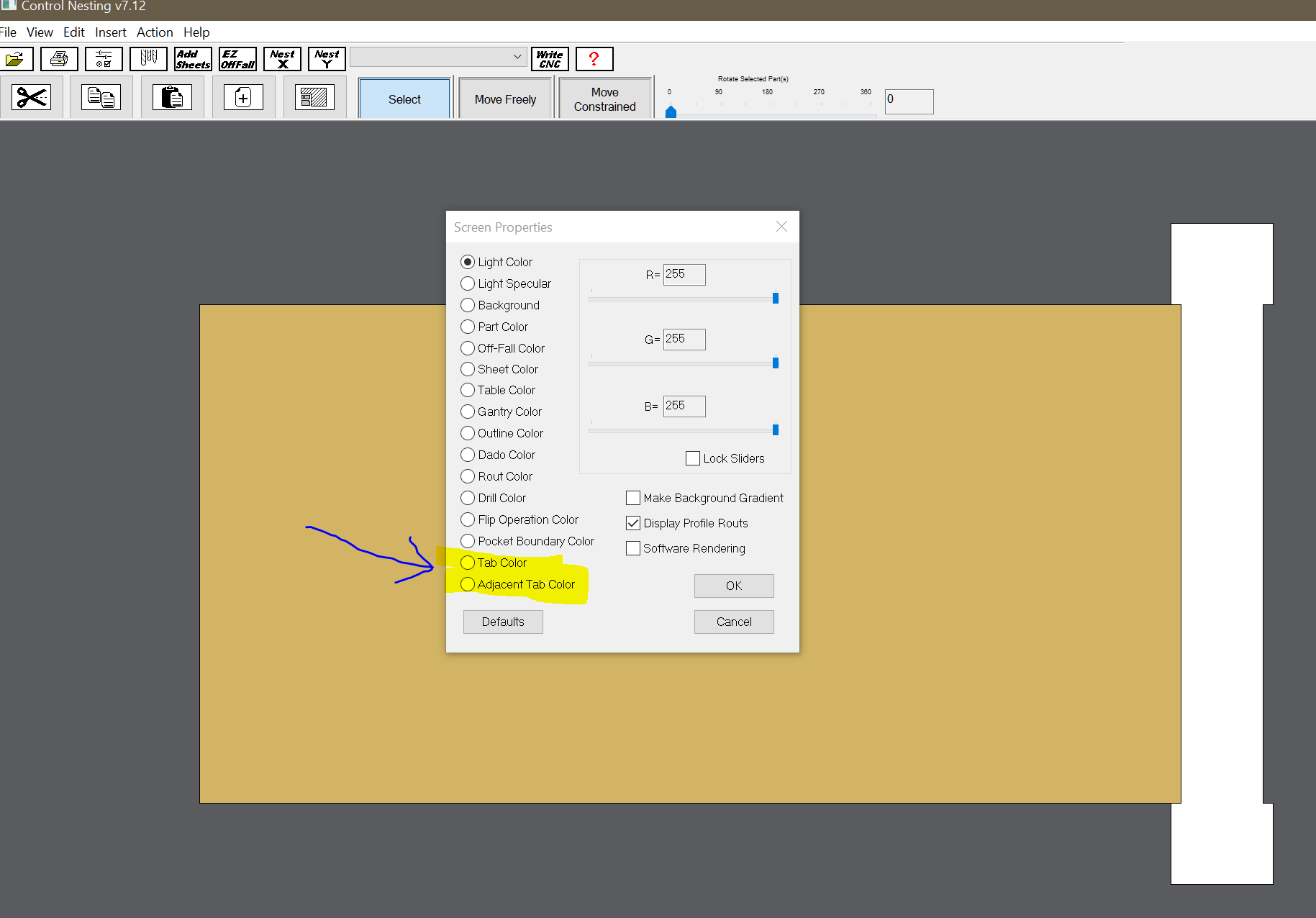

Stuart, have you tried adjusting the color settings? (Not sure they would be helpful - we haven't used the tabs, so I'm not sure how it works or looks in a nest)

I can clearly see tabs where they are placed on each piece. I cannot see if a tabbed part will be left with a skin when it falls within the "leave skin on parts with <N sq inch of area. I often nest parts that, because of their size and irregular shape, need tabs. I don't want to have these parts cut to skin because of the are threshold they often fall under. So I'm looking for a visual aid in the nesting diagram that will show when parts, tabbed or not, will be cut to skin instead of being cut through (multiple pass or tabbed). There is a color setting for the outline function, but it doesn't differentiate between outlines cut in each of these manners.
I often need to tweek the area settings for leave skin/tabs/cut through to avoid post processing an entire sheet of curved long narrow parts. It's a guessing game with parts that have irregular shapes. I'd like to see, when in the nesting diagram, which parts cut through, which parts are tabbed, and which parts cut to skin. When tabs are on, parts cut to tabs and parts cut to skin (with tabs), show only the tabs. There seems to be no indicator of the parts cut to skin based on the area.
