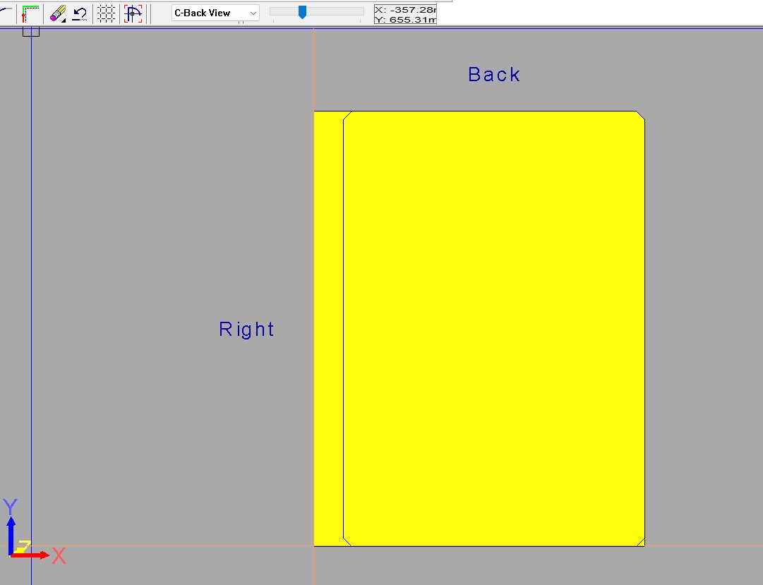

Re: bug with adding fillet on drawers
Hi Thomas.
I added some champers and I see something strange happening to your drawer box as well.
